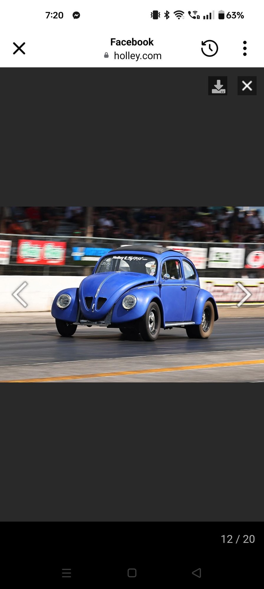

Originally Posted by gametech
I'm not usually one to call any amount of power excessive, but the Karmann Ghia was designed around a 34hp engine, lol.
Well so was his Bug. 🤣
