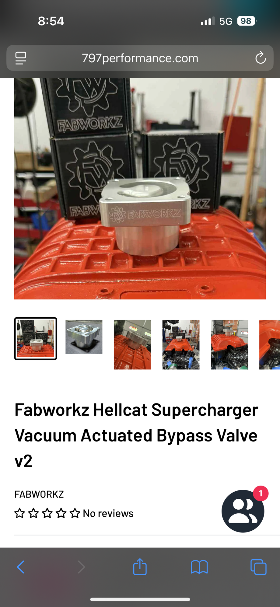

My only hang up with trying this is, I don't want to be bothered with dealing with having to run a standalone bypass valve/boost controller.
Why couldn't it be a simple vacuum/boost referenced deal like the LSA lol.
If it weren't for that I'd probably have one to play with already.
If I'm misunderstanding how this works by all means, correct away.

https://images.app.goo.gl/schfVdL4qtj3xAQu9
Can't be that hard to fab something up.

Just seems like ALOT of weight and hassle for something a $450 turbo could do a better job of. I'm a fan of the "whine" though... lol
Why can't you plug that stepper style OEM valve and plumb a mechanical one in in its place? The NIVLAC57 guys just did one. They implemented the OEM valve.

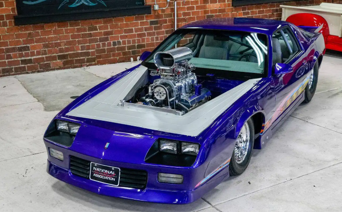

I agree. But putting a giant *** non symmetrical ugly thing on top of your motor rubs me the wrong way. The "old school" roots look so much better. That thing just looks goofy up there IMO. Need a hood to cover it up. Hurts my OCD brain just looking at it!
If your gonna do it....

I'm using a djtuning bypass harness plug and play
