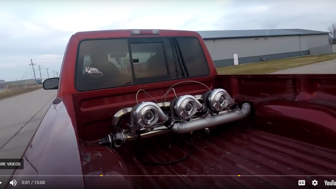

Feel like people don't go small enough if they want response from twins. Esp. rear mount units.
Neighbor had a set of tiny 16g DSM turbos on a 351 ford. Made boost like a roots blower. It was done by 9lbs or so, but holy hell it lit them off quick. Believe a 16g is a 48/49. No idea what the back pressure was, but there was no real transistion to boost. It was just NOW. I’d guess it was 550-600whp. But it drove like an NA motor.
Can always throw on a 3rd if its not enough!

Feel like people don't go small enough if they want response from twins. Esp. rear mounts
Exactly. And let's be honest here, because we all know turbo noises and burnouts are what turns heads at car shows. Both are far more difficult with oversized turbos.
