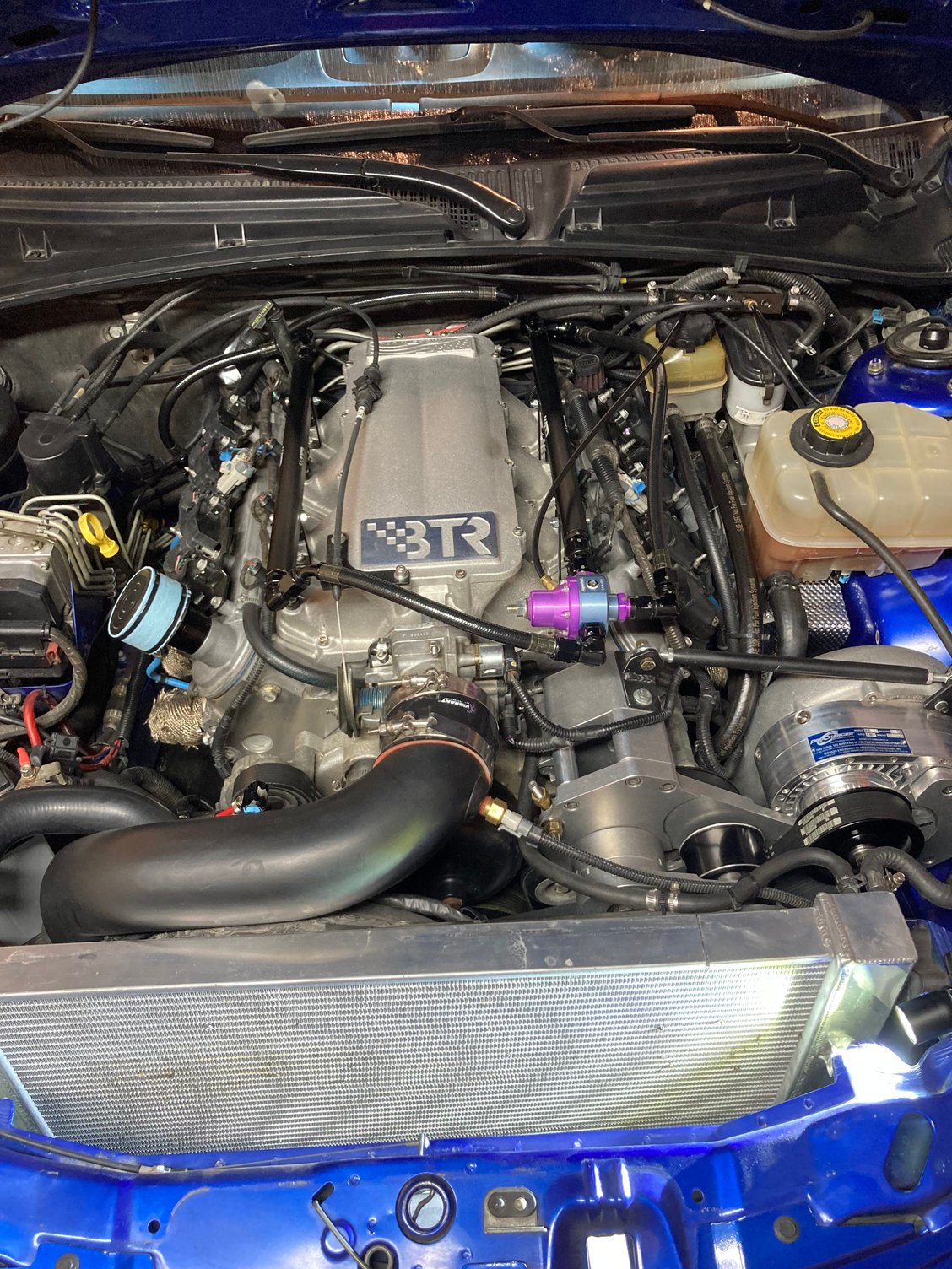

Looking under the hood I may have a decent plan to do this rather easily.
Basically I could remove the current intercooler and all the charge piping after it. I would keep the current charge pipe from the blower to where it connects at the bottom of the current intercooler. From there I would go straight over and up over the radiator to the throttle body. If I cut the lip there I can fit a 4” pipe. If I get the Holley low ram bottom shell kit and the 2300 hp shearer intake it should fit under a 4” cowl hood.
Best news is wife is onboard after I explained how we may gain boost and have lower iat while cutting weight without the big intercooler, extra piping, and fiberglass cowl hood instead of the current stock steel hood.
Any concerns with this plan? Tank in trunk and hoses under car. Fuel system may need changed up a bit due to location and im about due for a second magnafuel pump or possibly aeromotive higher flowing single. Don’t know on that yet.

Forgot how crammed the bay is in a GTO. Always think it is similar to that of a G8, but they clearly moved things around when they redid them. Short of deleting res tank and deleting/relocating ABS, not much room in those engine bays.
I think your plan is sound. I wouldn't bank on too much weight change, would net similar or possibly even more I imagine, don't forget if doing a trunk setup for cooling water weighs a lot, especially when typical trunk tanks are 5 gallon. I think it would gain from a larger inlet too from standpoint of airflow.
