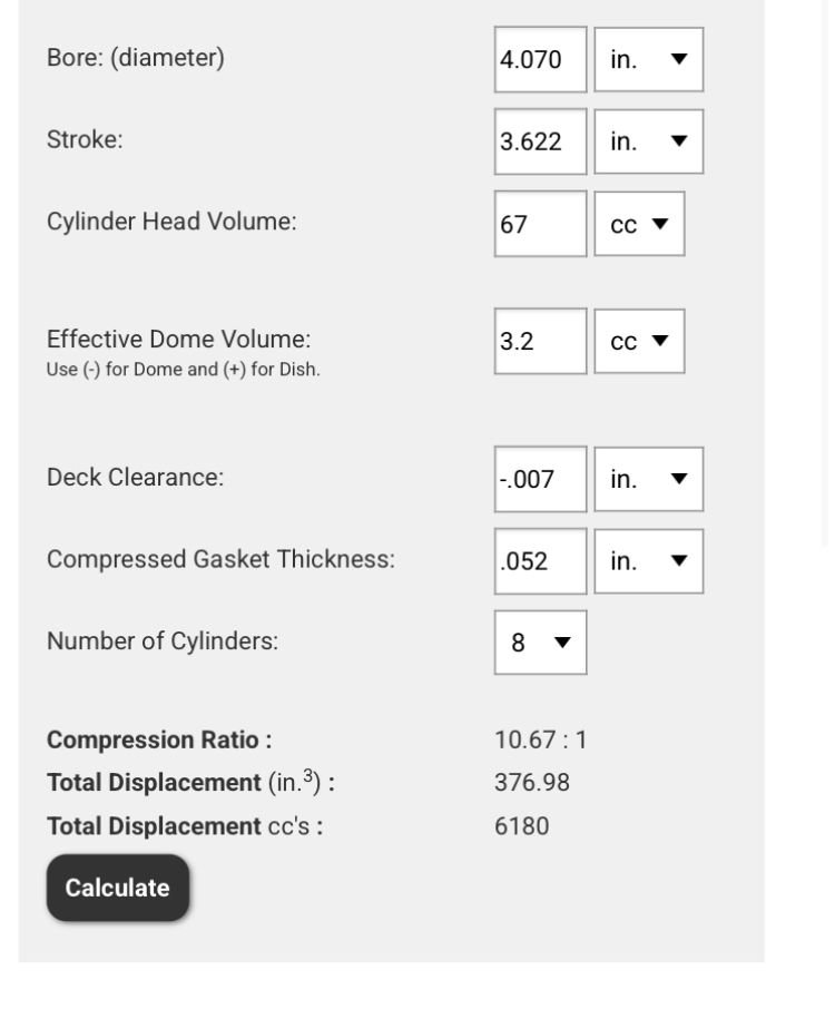

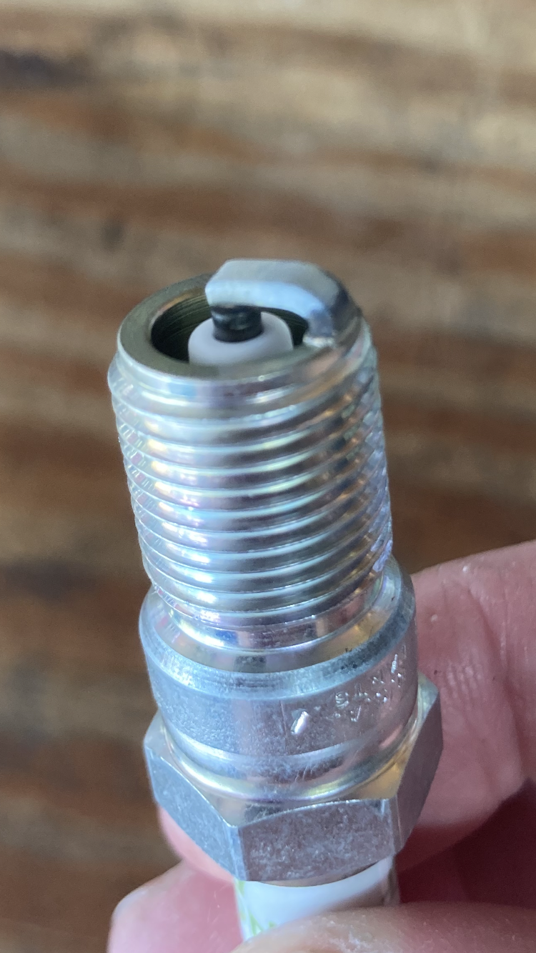

What is your compression ratio, what fuel are you running, and how much timing do you have in it?

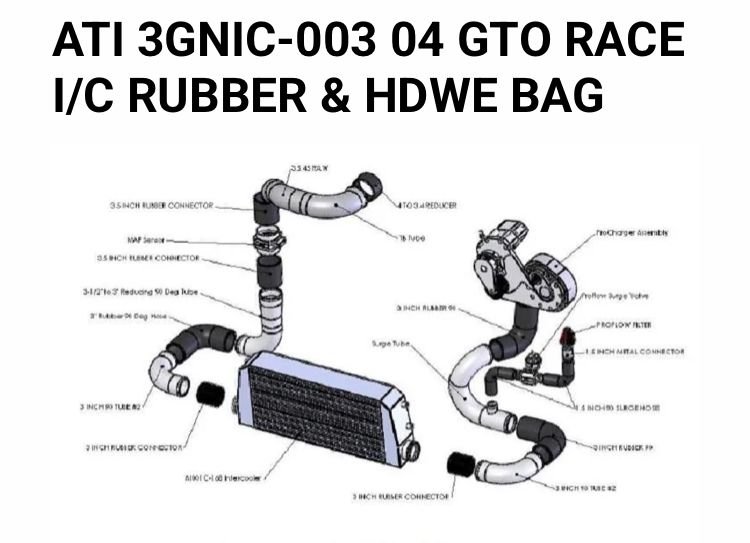

I will tell you right now, a major restriction is that air to air intercooler you are running. You would pick up big time by running a good custom A2W Garrett core setup, we've picked up 150 rwhp before switching to our custom A2W setup we make on the C7s and Gen6 Camaros with no other changes. Honestly before changing anything else I would seriously consider moving to an A2W setup.

Compression ratio:
Fuel is 50 percent ethanol and water/meth with size 9 nozzle on at 5 psi. Peak timing is 19 degrees.
Spark plug after a pull:
I will look into the A2W setup. I’ve had that mentioned to me before but ignored it since my iat is so low but I never thought of the intercooler itself being an airflow restriction.

So as an example I could run something like this and eliminate my current intercooler, all the extra plumbing, and go straight from rhe Procharger to the throttle body? This would remove a bunch of weight off the nose and put the water/ice tank in the trunk.
