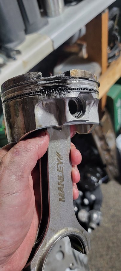

Originally Posted by 98Zeric
thanks man, i really appreciate that! It's good to know I'm not alone lol.
​trying to narrow it down, so far i know it is not the injector
Looks like it went lean and burned. I agree with the others on getting a new tuner. I just helped a guy out with his tune on his Terminator X and I felt bad for the guy cause he paid $500+ for that "tune". It was so far off I'm surprised the motor stayed together
i agree about it going lean, just nor sure how or why. I'm 650 for the tune. I posted it a few post ago

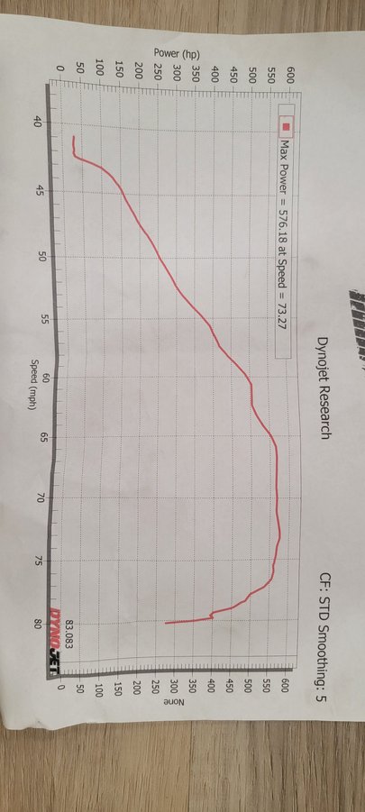

Maybe I missed it somewhere but where is the dyno graph showing it was lean? I just glanced at the tune and while it needs some help it was commanding a mid 11 AFR at WOT which is fine and it had timing commanded from 7 to 11 degrees at WOT in boost which is pretty damn low and "safe" IMO. It also still had a stock Tahoe intake air temp retard table in it which is VERY aggressive. I mean there are other things in the tune that I dislike, but I don't see the immediate cause for a melted piston assuming the dyno was showing a mid 11 AFR and timing being as low as it was. This almost implies to me that something else happened, like a fuel pump took a **** or wastegate didn't open, etc.

All, thank you for the help trying to figure out why. I call the guy that tuned it, and who also owns the shop.told him what happened. He has a injector flow bench (not a cheap one) and tested the injectors, which all performed perfectly.
dyno graph

That graph doesn't show AFR at all, do you have something showing that or can the guy send it to you? But actually seeing that graph it rolled over pretty hard... what is your full engine combo? I think you said it had a sloppy stage 2 but what valve springs? Any idea on installed height/seat pressure? Valve float will show a serious roll off at the end, kind of like what I'm seeing in that graph.
nope, gotta be the lamest graph ever handed out.and i did ask. Brian tooley .660. Install height/ seat pressure was not checked.
The tune was commanding 11.5 AFR but whether or not the engine was actually seeing 11.5 AFR is another question correct?
Is the OP using any kind of standalone AFR gauge?
If power was plateauing at 5,200 rpm, wouldn't that possibly indicate a fuel delivery issue?
Well that's always the question and why I asked about what it actually showed on the dyno. I mean setting the actual AFR to match commanded in the VE table is the probably the easiest part and one of the first things that happens during the tuning process so I usually give somebody who tunes for a living the benefit of the doubt on that at least.
Could be a lot of things, but valve float is usually at the top of the list for me especially in turbo applications just because I've seen it A LOT. It doesn't look jagged enough to me for blowing out the spark but that's a possibility too.
The part that makes me most concerned is from the very first post, he said that he is trying to tune it himself before the dyno tune and he was commanding a 14.7 AFR at WOT. What's to say that the damage wasn't caused from the initial tuning attempt and ANY pulls after that just made it worse?
