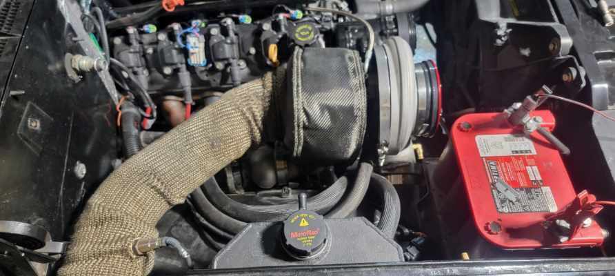

While doing a little tuning on my truck after turbo install(I'm only a novice at best), I'm noticing the boost doesn't start untill up in the 3k rpm range.

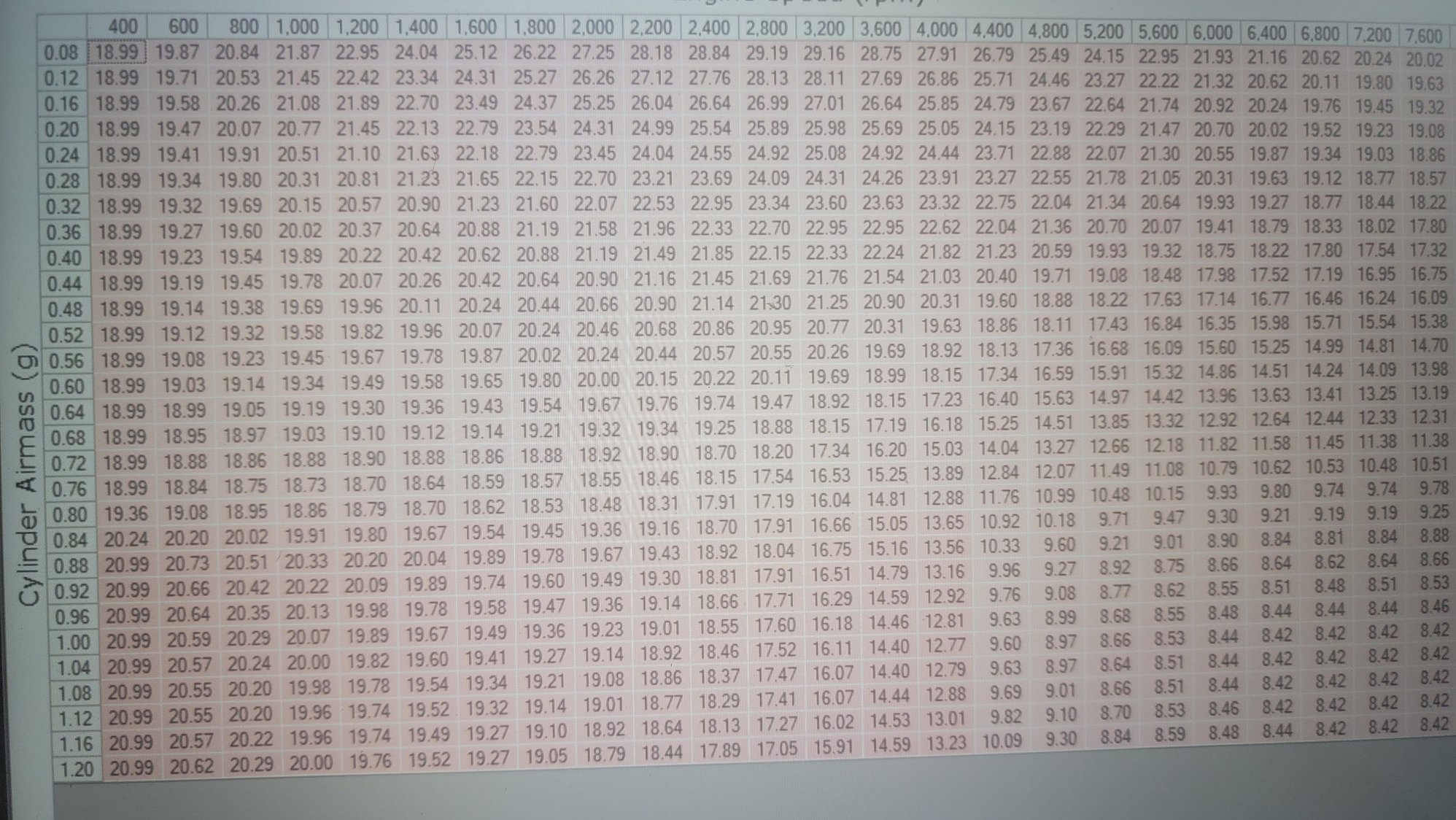

To give an idea of what the tune looks like, and i'm not implying there isn't room for improvement, spark advance currently is around 18-21*
Fueling resulting in a 14.7 afr
my dilemma is, i have a dyno tune set up for August 14th i don't want to spend $750 to find out that power below 3,300 with this turbo will be disappointing, as it seems to be now. When i could use that money for a turbo in the rpm range i would be happier with. Another concern i have, i do not want to over spin (if possible) a smaller turbo or have it be a choking point when i am in the highr rpm. I also have a AEM boost controller that doesn't seem to make a difference when changing duty cycle, again, I'm new using those.
Currently have a Vsr 80/88 with a 1.30ar
motor is 398ci (6.52 Liter)
Turbosmart WG60 w/10lbs spring
A2A
525 lph pump
​​​1000cc FIC (clinic)
-8 fuel lines, feed.
91 octane.
94 RCSB chevy truck
awd
Automatic
I know the current tune is not perfect, i just don't know what to expect with my setup. but a fun street car (truck) with some occasional track time.
I tried looking at turbo compressor map to see where my current turbo will be, but no luck.
For max hp = 74.1 lbs/min @ 14psi
for max mid = 35.8 lbs/min @ 14psi
according to some calculator I used online.

Your AFR is 14.7 at WOT? Not good. Not good at all. Best to get that in line before worrying about anything else.

ya..i was a bit nervous about that, should be little richer, correct?
i only made one pull and noticed it, i have not drove the truck since. I will be adding more fuel

At wot, out of boost (with pump gas) it should be in the 12's (I like 12.5:1 personally) but in boost, it better be in the 11's. 11.9 is good on 1-2psi but I start fattening it up as boost goes up. I run a touch over 20psi and its around 10.6-10.8:1 (this is what I do, its worked for me for years without having to replace a head gasket). 14psi will be around 11.2:1. So as you can see as I go up in boost, I go up in fueling. You see 14.xx afr in boost....you better let off quick.
14.7:1 is good for idle and cruise (very light load). I I increase load, I add a little fuel.
Thank you for explaining that
