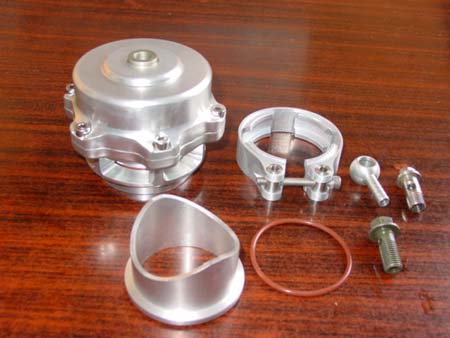

Can I buy any old BOV? I have a P1SC pushing (well going to be pushing) 8psi. I found this one on e-bay and was wondering if you just order the BOV and hook it up? Is there more to it?
BOV

KNockoff Tial BOV. They are crap! Remember you are trying to protect a 2000$ blower and an engine... dont skimp

Bov's are adjusted through the spring pressure. You can swap springs out get more or less pressure on the diaphram/piston. It is pretty much just hook up a vacuum line. The BOV will go anywhere between the maf and intercooler. It must stay before the maf no matter what. Most people around here like the Tial Bov's that run around 200-220$

You will need the correct flange for the size BOV you have. I had mine tig'd right after the passenger side intercooler. Just where the stock ati surge goes. He cut the 2 inch pipe, welded the flange, and she just snaps right on there. I paid 45 bones for the flange and the tig.... Gotta love those ricers
