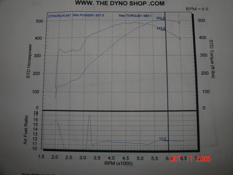

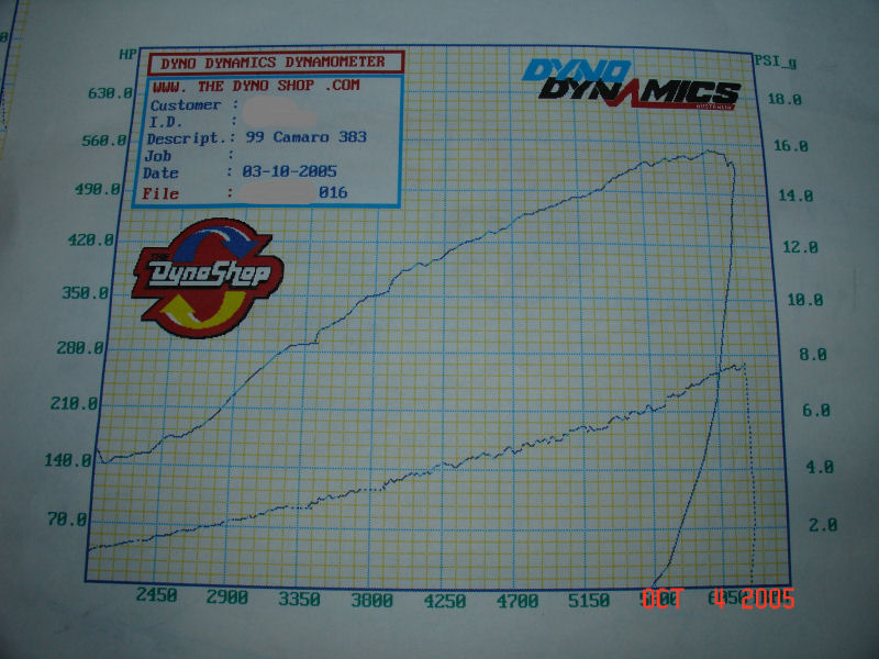

thats really strange that you went from 550rwhp on a load bareing dyno to less than 500rwhp with a no load bareing dyno.Does the car feel different or slower since you first dyno'd it and made the 550rwhp?the cam was speced for your particular app so i dont think thats part of the problem.Try a D1 and ditch the twin intercoolers.

I did noticed on the dynojet the peak HP was only @ 5600. But on the other dyno it keeped climbing to 6000.

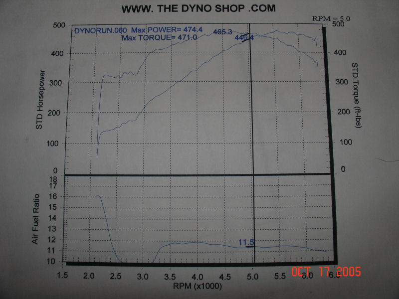

The first sheet is my first run on the dynojet. I also noticed that it is STD and not SAE.
The second one is where I richen up the AFR up top.
And for reference the dyno dynamics sheet.

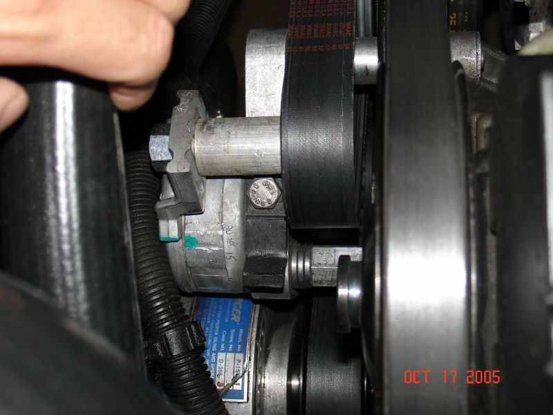

Here is a pic of the tensioner mark.

Go a lil tighter on the tension....... i ran mine up around 19-20 and i had very little belt dust from normal wear.......

I'll try that. But does the belt look a little short to you?
Now that you mention it, it does look shorter then mine.... mine was more over closer to the stop....i couldnt see that bolt....... what size belt??? what brand??

SDCE sent me a NAPA 080510
