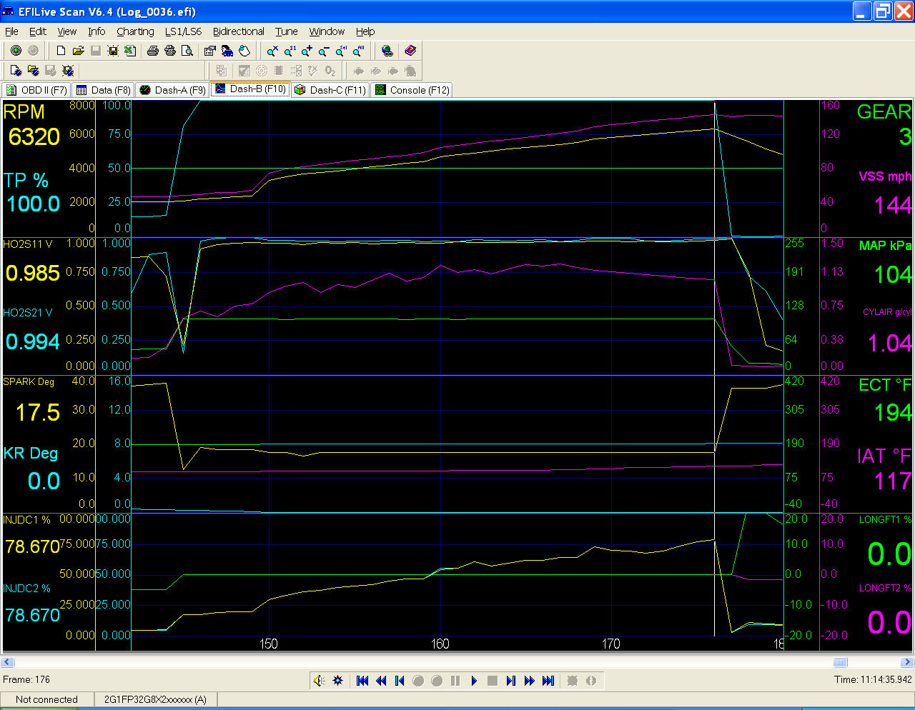

Here is a log from the dyno.

dyno looks OK, heavy car like that could use a little more gear at the track though. I would put a decent wideband in the car, it looks like you may be a little rich there and even with 91 you should be able to ru a little more timing with that amount of boost, especially at lower RPM.
post up the log from the dragstrip video you posted if you can

I thught 11:1 - 11:5 was fine for FI? I know I gained 30 rwhp when it was up to 12:1
I had the timing up to 20 with no knock. But no increase in HP up top. So backed it down. Next time I am on the dyno, I will do what I always do. Start the timing @ 20* then ramping it down by 6500.

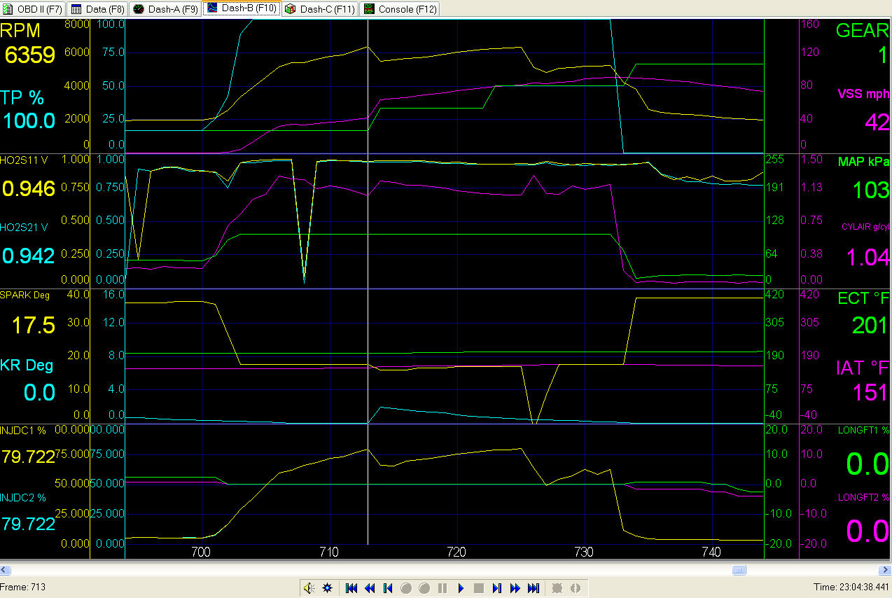

Here is a log from the track. But I think it was with a 50 shot. I'll try to find the one without N20.

you can probably start the timing a little higher then 20, peak horsepower on the dyno and getting a heavy car moving at a dragstrip is two different things I would keep the timing around 25 under 4500 and start ramping down from there but thats just me.
Well, I run 12.5:1 a/f or so at the track, 11.5 will slow me down quite a bit. I really dont trust dynojet widebands, if they arent maintained they will read all over the place. Every combo will react to timing and a/f a little different, 11.5:1 is very 'safe' but will also cost power - dont be afraid to experiment a little with things on the dyno. I dont even bother much with the dyno anymore, with the wideband in the car I do all my tuning at the track

another thing is your IATs are way up there at the track, that will cost you big time power. Try not to let the car run for a long time and vent your bypass to atmosphere so its not jamming all that warm air back into the inlet. If I make 2 back to back dyno pulls and my IAT is over 150 I lose 50-60rwhp. You can use your IAT table to pull some timing at the top end of the track as well, it spends more time at higher RPM in high gear so a little timing out on the top of 3rd gear wont hurt. Here is a 9.7x @ 138 pass, its a little lean but the temp was cooling off quicker then I could compensate - didnt blow up though But this is the a/f going down the track, not on a dynojet you have to remember. I dont want you to blow your car up, take it easy and a step at a time but you have more power there..

You know I just remembered something. On both dynos, a couple of times my AFR shot down to richer than 10:1 under the curve.
What else could cause the AFR to be really rich?? I wonder if that is what happened on the track. I am going to see if I have those EFI logs.
This is starting to make sense. That is probably why I could not lean out the AF under the curve with PE.

Make sure COT is shut off, that will give you random episodes of the super rich..

i dunno if maybe im reading your log wrong ed but it looks like your injectors duty cycle#1 dropped to 50 in the same place that you picked up some knock,maybe im just pointing out the obvious dunno if itll help
Thats when the tranny shifted.
