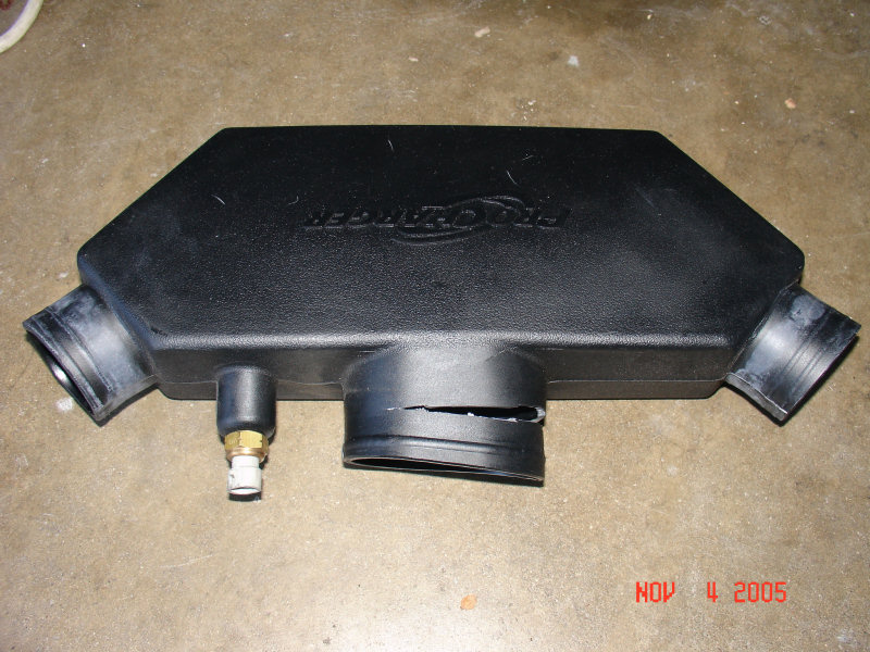

Hopefully replacing the leaky plenum will help.
Borrowed one from Rob for the track tonight and dyno tomorrow.
I also ordered a 3.2 blower pulley. Think I can get away with a 3.0??
3.2 will spin the blower @ 6400 59450 rpms
3.0 will spin the blower @ 6400 63413 rpms
Oh yeah u can get away with it.... even with SDCE's better design your always goin gto get a lil ya know... be sure to post up your results tonight.... do you see any difference in your boost gauge now with the new plenum u borrowed????

Posts: 3,066
From: Sunny San Diego
Cool, just changed my order to a 3.0 pulley
I didn't really notice a difference. But too much traffic, couldn't get the rpms over 4k.
Hopefully I will notice something at the track over 5k
Thanks again Rob.

Well the track showed no real change, so I guess that wasn't it.
Still only got 7# of boost. I guess with the larger motor I need to change the pulley. If that doesn't do it, then I guess its time for a D1.

Got back from the dyno. I think the plenum help a bit. It did screw up my AFR. I am way lean now.
New numbers are in the sig.

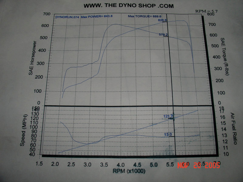

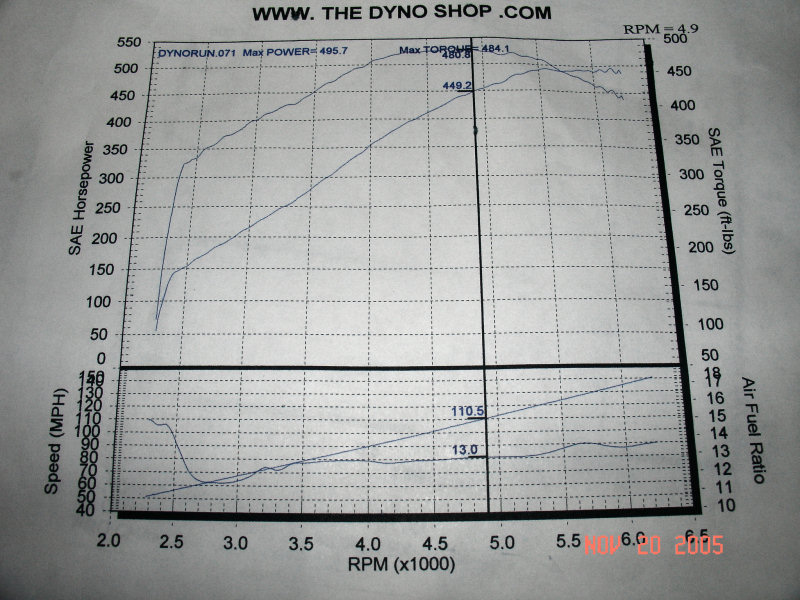

Old Nov 20, 2005 | 09:52 PM
  #76
Ed Blown Vert's Avatar
Posts: 3,066
Here are the sheets from the dyno. I have no idea why the AFR changed so much.
Old Nov 21, 2005 | 08:47 AM
  #77
ddnspider's Avatar
Posts: 14,628
Likes: 1,778
From: FL
....lower in the powerband you making quite a bit more torque.Like @ 3k you making like 75 more ft.lbs.but you dont have the hp to match.....You sure the tune is on?not doubting youre ability but the A/f was all over the place leaning out to almost 14:1....the bottom graph is pre-motor i take it???i looked at your website,very nice.but i was looking for your fuel mods....you sure you arent running out of fuel with only 1 intank and 42#ers???
Old Nov 21, 2005 | 10:12 AM
  #78
Posts: 3,066
I don't know what happened to the AFR. You saw the other graph. My AFR was about 11.5
Only change was the new plenum. I didn't get any knock. :dunno:
The bottom graph is a 150 shot.
I don't think so. Before I tuned it my AFR was really rich down in the 10's. I am running the Racetronix with 60# Mototrons.
