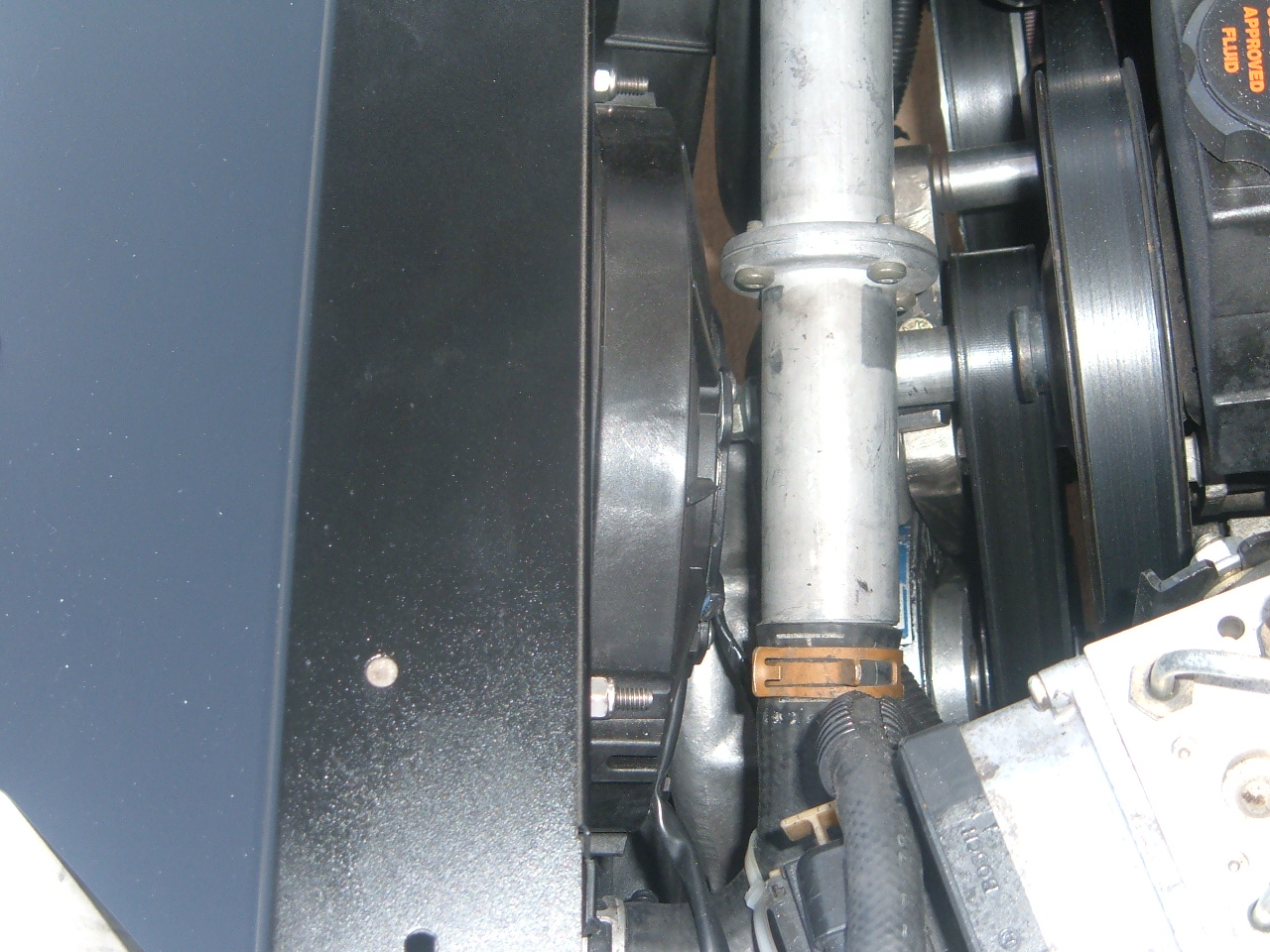

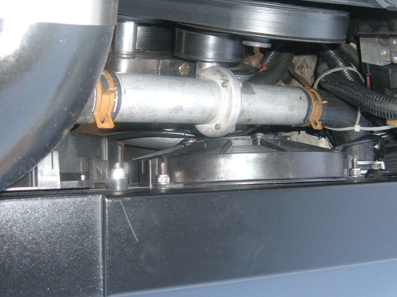

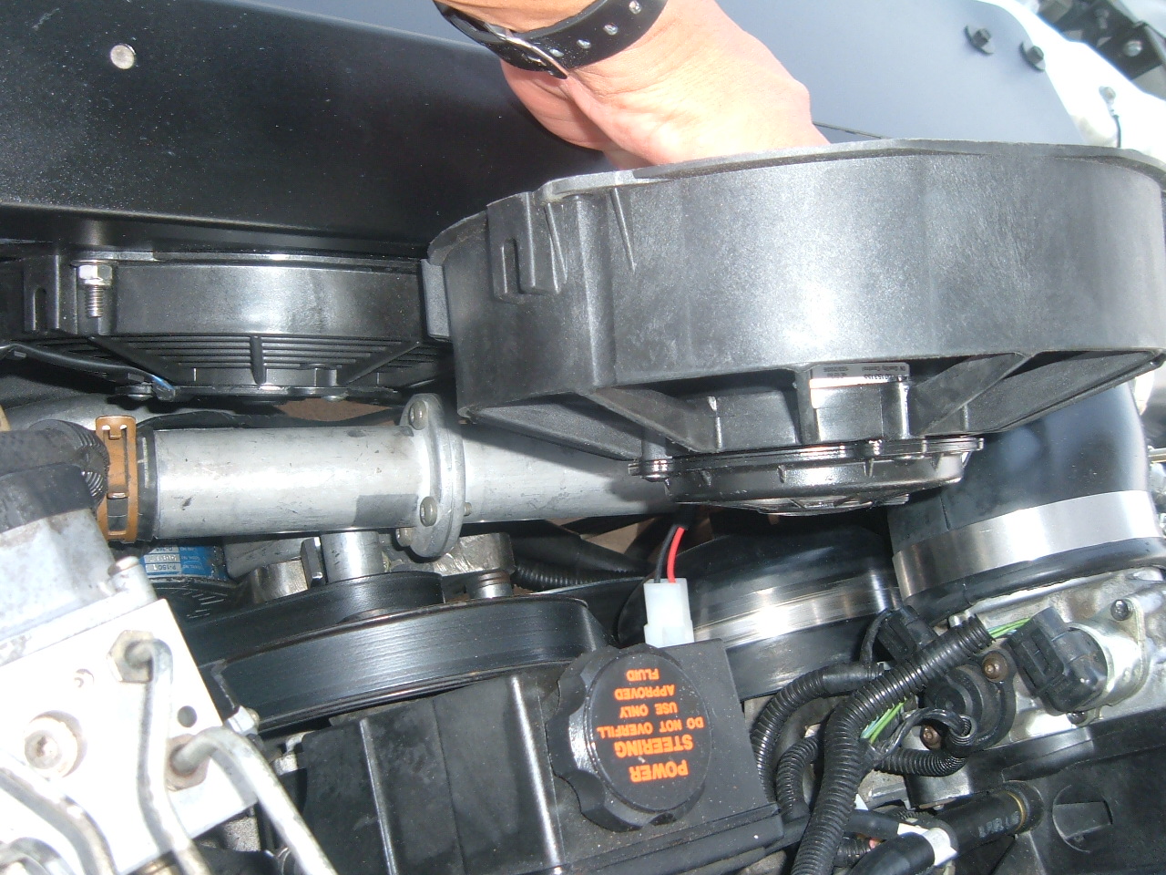

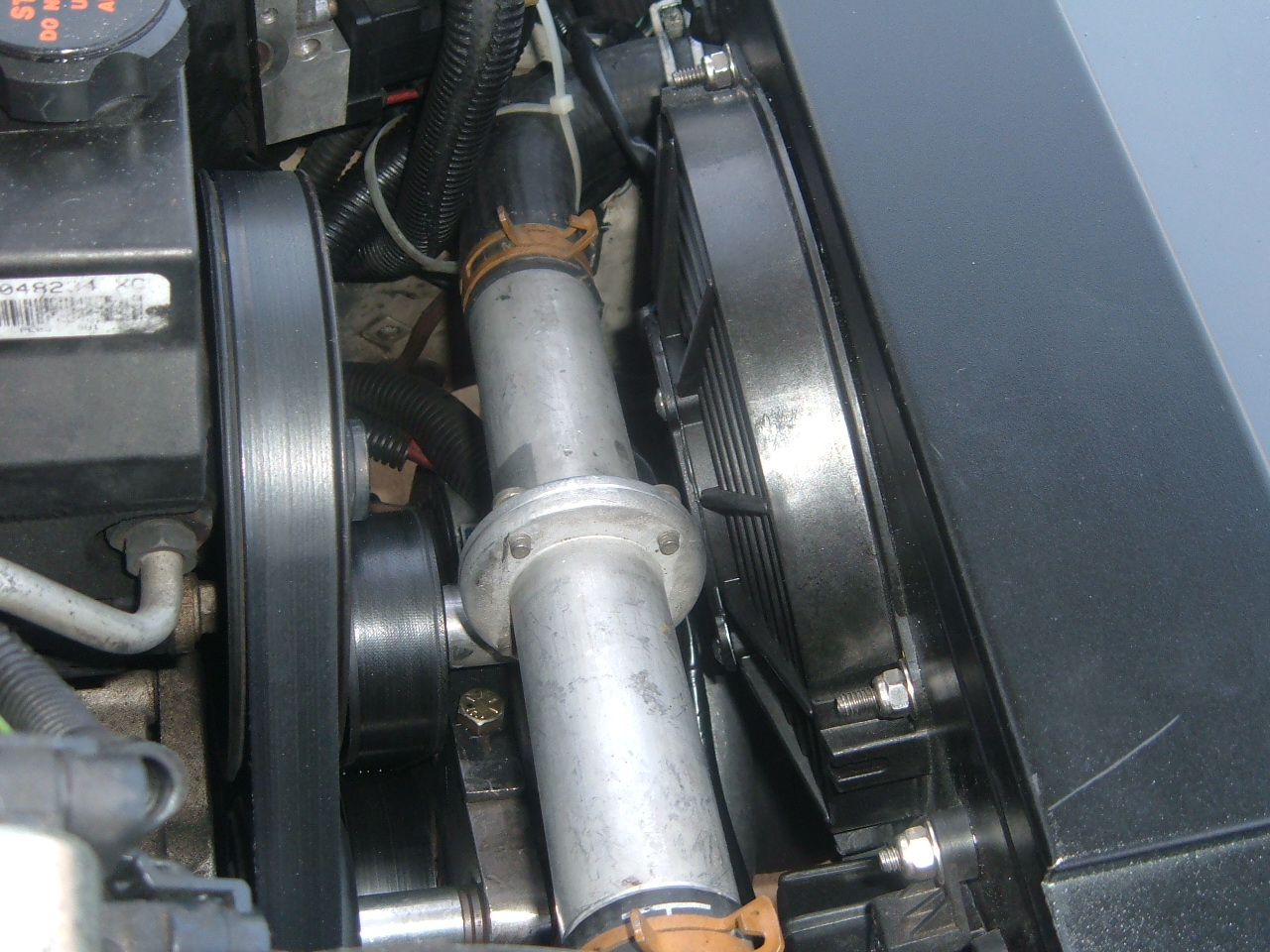

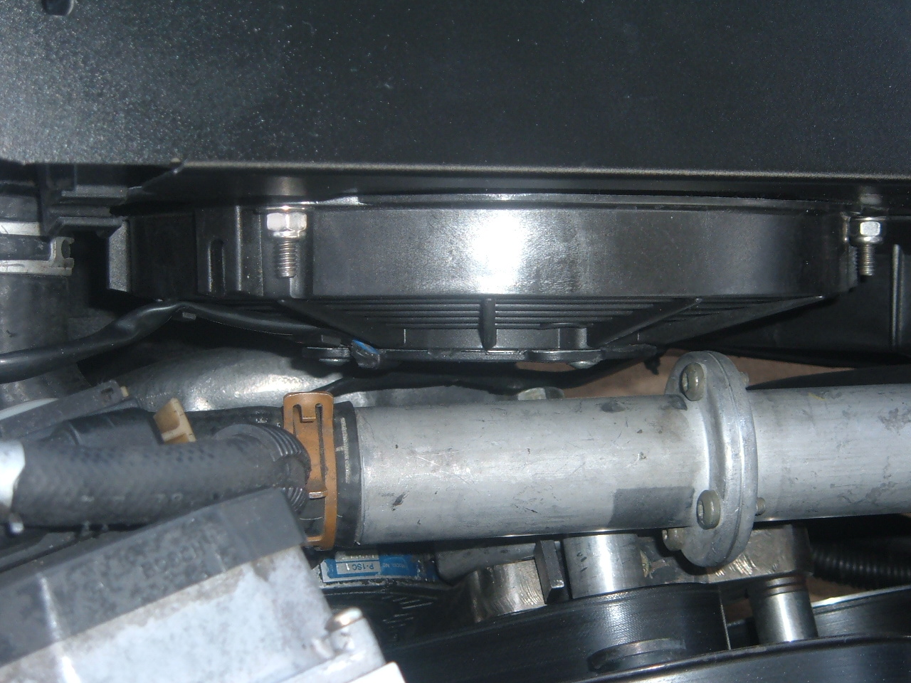

Here are your pics

Thanks Ed. The last picture is the Spal high performance fan, http://www.spal-usa.com/fans/automat.../2061-2053.pdf . As you can see the fan is pretty thick and does not fit with the SDCE. Do not get this fan!!!!!!
