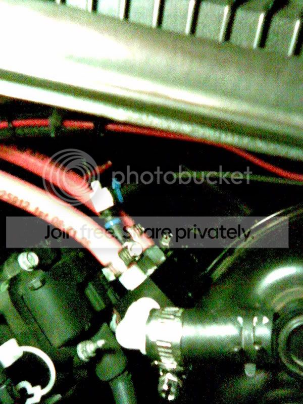

I'm going to try something new with my pcv system tonight and just wanted to see what you guys thought. The plan is to run a breather off the oil fill cap, run the return line to the drivers side rear port, cap off the manifold, TB, and both ports on the passenger side valve cover.
Do you guys think this will vent the crankcase enough? My other concern is that I might get blowby out the breather. Please let me know what you guys think.

Some pics of my PCV setup.
Sorry the pics are small.
The 2nd pic is the return line that goes in the drivers side valve cover.

Heres what was done. I found this to be the simplest way to do your pcv system without drilling for the return line.
- cap off intake manifold, TB, passender side valve cover ports.
- Add a breather (thunder racing) where the oil fill cap goes.
- run the oil return line to the rear port on the drivers side valve cover. I took the quick release fitting off and connected the fitting from the pcv that plugs in the drivers side valve cover, fits perfect. This seems to be a really clean setup that works effective.
