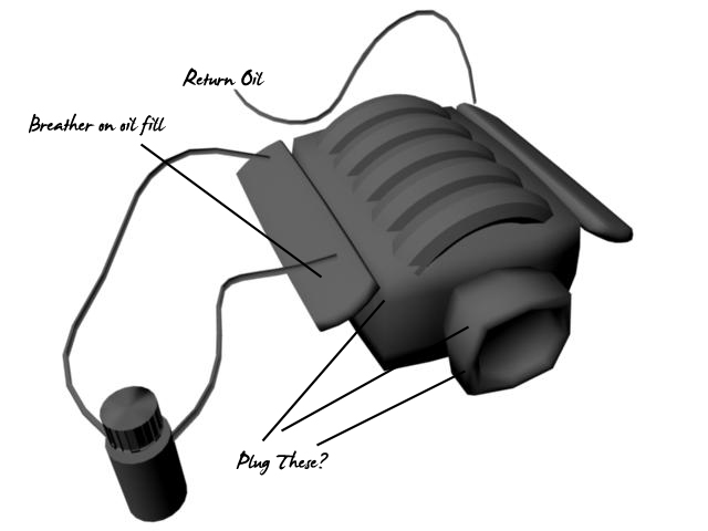

I just got done talking with Rick Squires at STS. We were talking about a simple way to re-due my PCV system. Here what we came up with.
1) Run the return line to the pcv port on the drivers side valve cover.
2) Breather on the oil fill.
3) Plug the TB and intake manifold.
4) Run both ports from the passenger side valve cover to a cc w/a breather.
This seemed like the easiest method with out doing any major work.

How do you put a breather on the oil filler when the return oil is going into it?
Anyway you could draw this up?
Heres what I started:
Edit: I just realized you were saying run the oil return to the driver side PCV. How do you do that? Remove PCV? and is that port big enough for oil return? Is your PCV setup stock or do you have LS6 valley? Would this eliminate the need for a check valve?
The port on the drivers side valve cover is plenty big. Pull the quick release off the return line and hook it up to the pcv port that was going into the valve cover before.
I'm currently running the STS PCV system with a check valve and CC. The reason I want to change to this setup is because it will help with the ventalation, plus theres already to much oil on the passenger side.

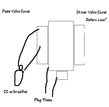

Heres a more clear one. Do I yank the old PCV tubing and keep the PCV valve? And plug the hose going to manifold and the two on the TB? Doesnt the CC need vacuum? What if it had two lines coming off pass valve cover and third inlet that went to the compress housing for vacuum under boost. Any pics of your current setup. sorry im lost with this PCV stuff.
I'll take some pics for you tomorrow.
