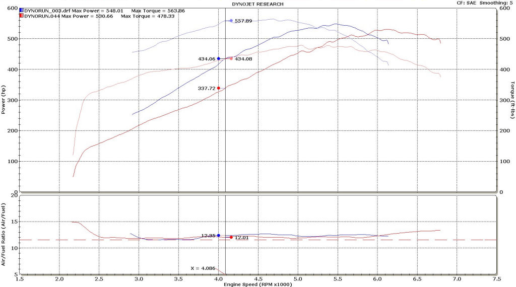

Originally Posted by ty_ty13
i just thought of this... im using the mondo, but i just saw that the O-ring under the plunger had been knocked out.... maybe since i glued it down ill gain some more boost and get a higher rpm Vs. Map value in my VE tabel.. i could have been losing boost cause it couldnt seal well enough after 5800 motor rpms....
i'd say check your stock ATI bypass as it makes the most sense.... I'll let you know what happens with mine.... if its not the bypass on mine or yours i will be looking at the cam for the blame.....
i talked to a reputable procharger sponsor and i asked him where he thought a 224/236 cam would peak at and he nailed my dyno sheet right on the head... 5800rpms.... he said he would like to see my motor have atleast a 234/238 114lsa... maybe the intake duration on a procharged car can make for a longer power band..
maybe its just a coincidence maybe not... but hell i could see i was gaining boost on my dyno sheet but i lost power... so when this winter comes and my theory is still lurking... i'll check into a set of after market casting heads and a BIG cam...
I can see the cam making my peak earlier. And I should have went larger with the 383, but I have to consider smog just in case. With the previous cam of 224/224 .595 114 I peaked over 6000
What I don't understand is why the boost is the same between the P1 and D1.
I'll check the BPV, but I realy don't know what to look for.

Just for comparison.
Blue is current.
Red is P1 with stock cubes. 224/224 .595 114, 6.0L heads
