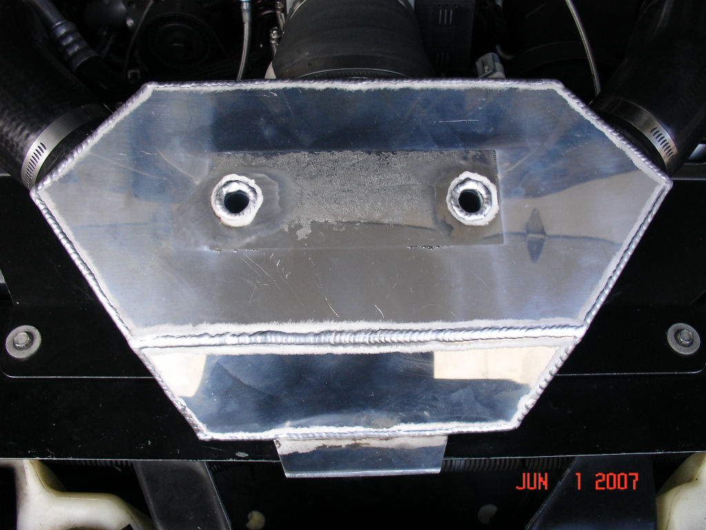

Best I could get was 548 rwhp 563 rwtq on 10#. Blew the plenum twice on the dyno. Then starting blowing the hose off the TB.
I didn't gain anymore boost. But under the curve I gained quite a bit.

Looks like you need to find a better tranistion piece and get rid of the worm clamps and invest in some T-bolt clamps. Good results though.

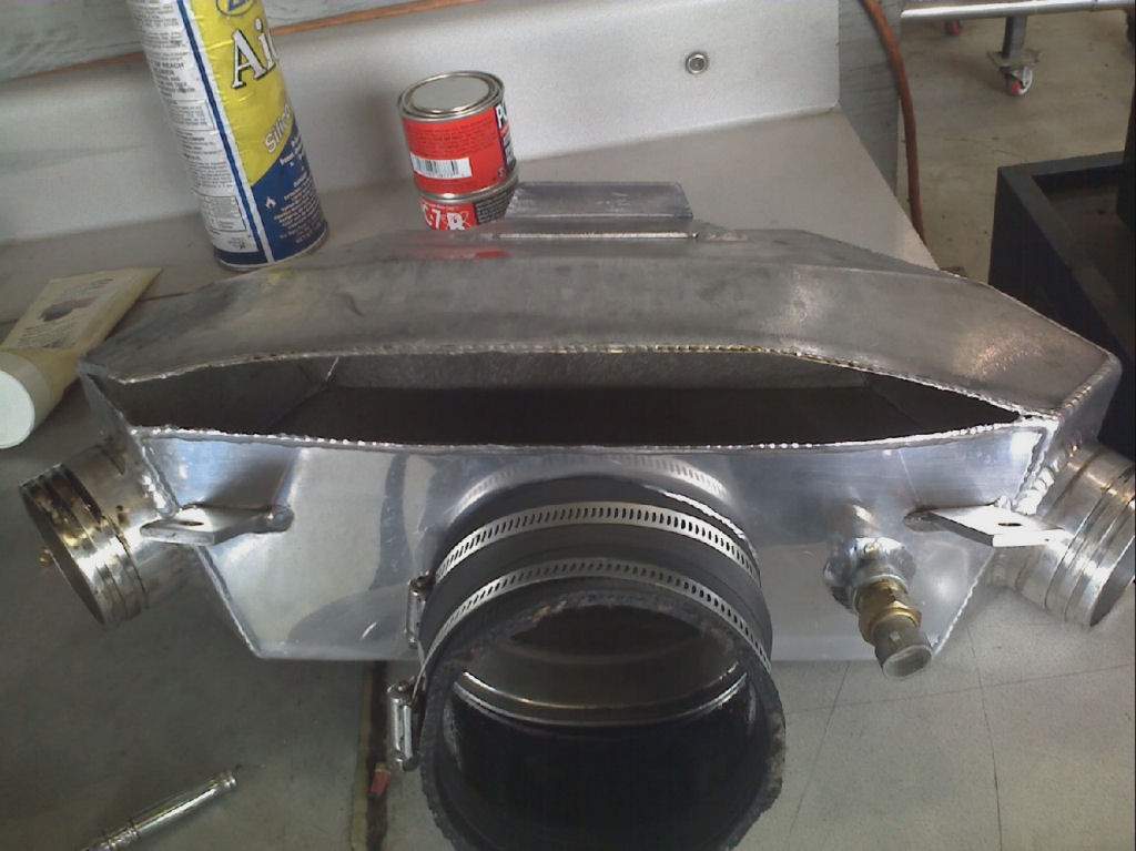

area under the curve gain is nice. but damn what a p.o.s plenum box. looks like you'll have to get a custom one made with heavier gauge stainless steel.
No ****. I had that area welded and it blew on the side on the next run. So I had them weld the whole box and put in two supports in the center.

I did have them weld the whole plenum and add two center supports. It held on the next two runs, but the hoses didn't
