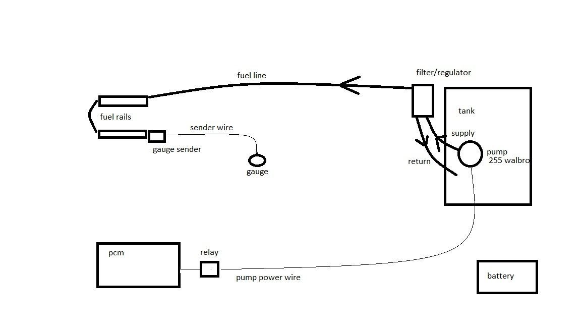

How about a couple drwgs of how you have it plumbed and wired?

Here is how I have the system plumbed and wired. The efi harness is a painless. I ran the pump directly off the battery and started the car but that didn't change anything. Since I was able to get full flow through the hose up to the rails I don't think there is an obstruction in the supply line. Today I will check the rails for blockage.
