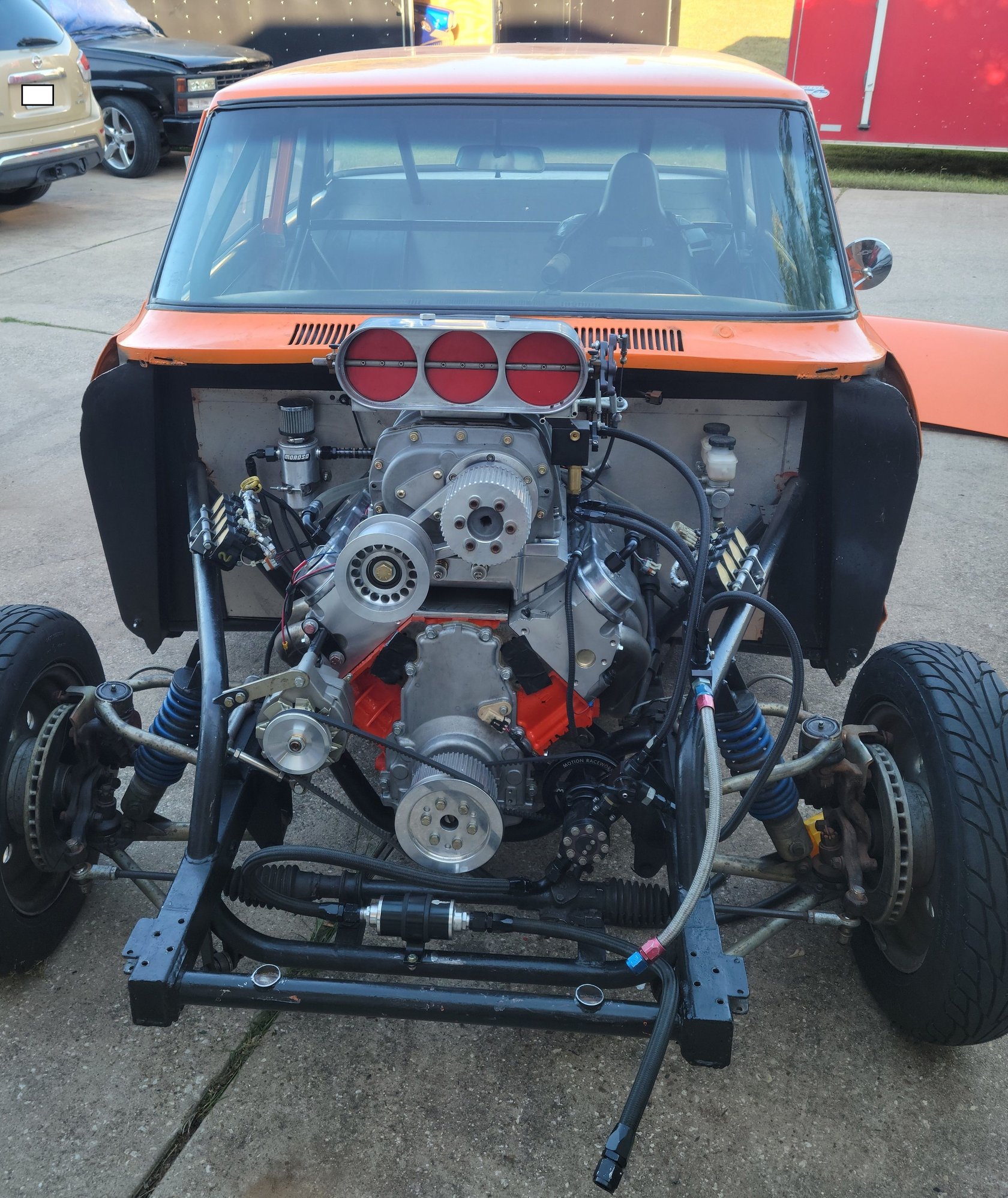

I recommend Motion Raceworks:
https://www.motionraceworks.com/prod...mp-bracket-kit
They also have the brackets for cable driven pumps, if you want to mount the pump in the rear. My fuel cell is in the front, so I mounted the pump in the front.
There's also a link to the ATI hubs for the crank pulley.
I should note that I only used their pulley, I had to use a custom mount for my pump. This is an LS engine using a mechanical fuel pump. If you use the correct regulator, it's the same for EFI.

Wow, what's that bad boy run?
Old Feb 27, 2022 | 09:19 PM
Onbusy's Avatar
Joined: Jun 2020
Posts: 200
Likes: 47
I actually haven't run it at the track yet. I haven't done mechanical fuel injection before, so it has been an experience getting it to run correctly. Alkydigger has been a great help, but I'm still working out some issues. I also have 2 more projects I'm working on at the same time, so I've been bouncing between all 3 of them to make sure I don't get any of them done ...
But, the car is about 2000lbs, 2 speed powerglide, and should be about 1000hp at the flywheel. Should be fun.
