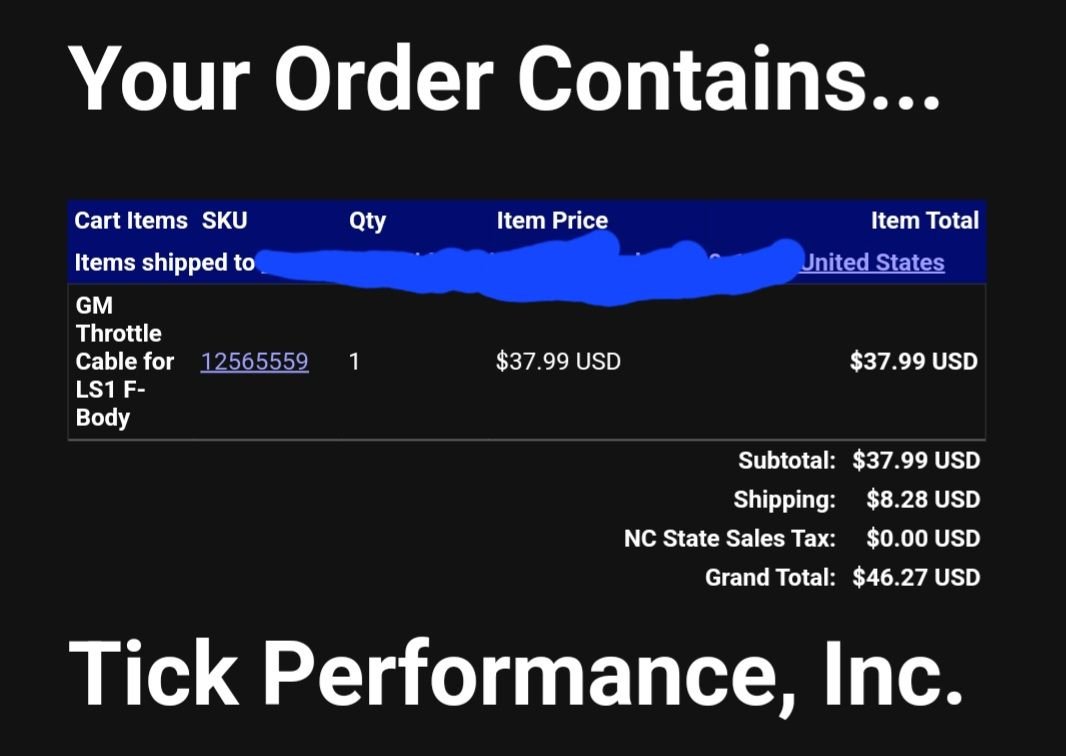

I plan on eliminating my tcs and cruise and saw that tick sells a gm throttle cable for non tcs cars.
I think it’s $37
I think it’s $37
Awesome!!
Thanks guys! Sucks trying to search for stuff with a phone. RockAuto let me down on this one, lol.
I ordered one just now.
