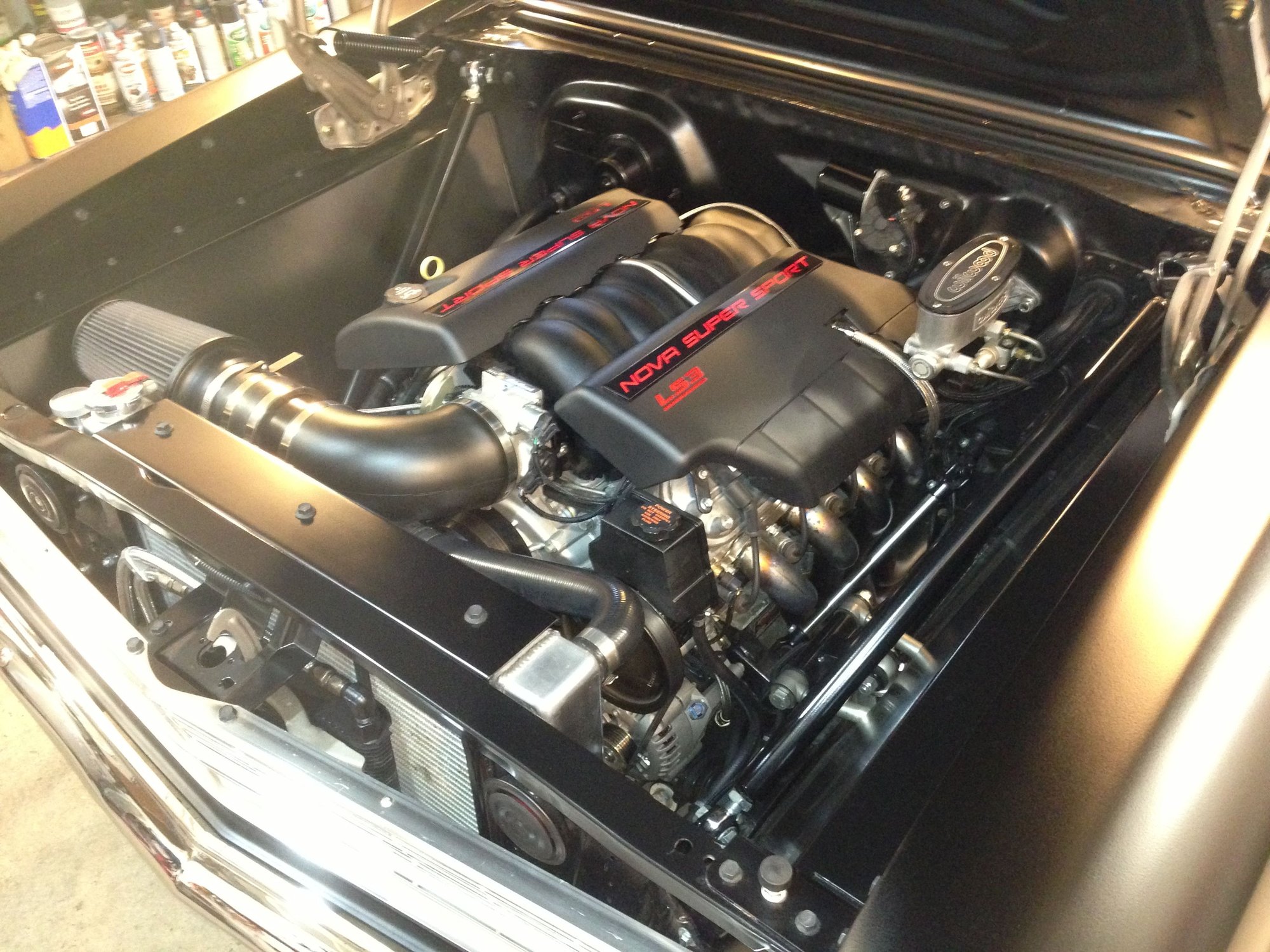

On my 67 Nova with a stroked/sleeved LS2 427 cubes I used the Holley DBC throttle body. Worked well.
