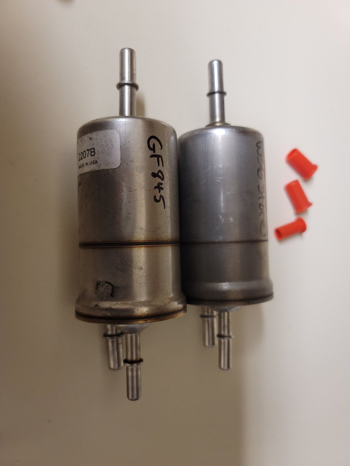

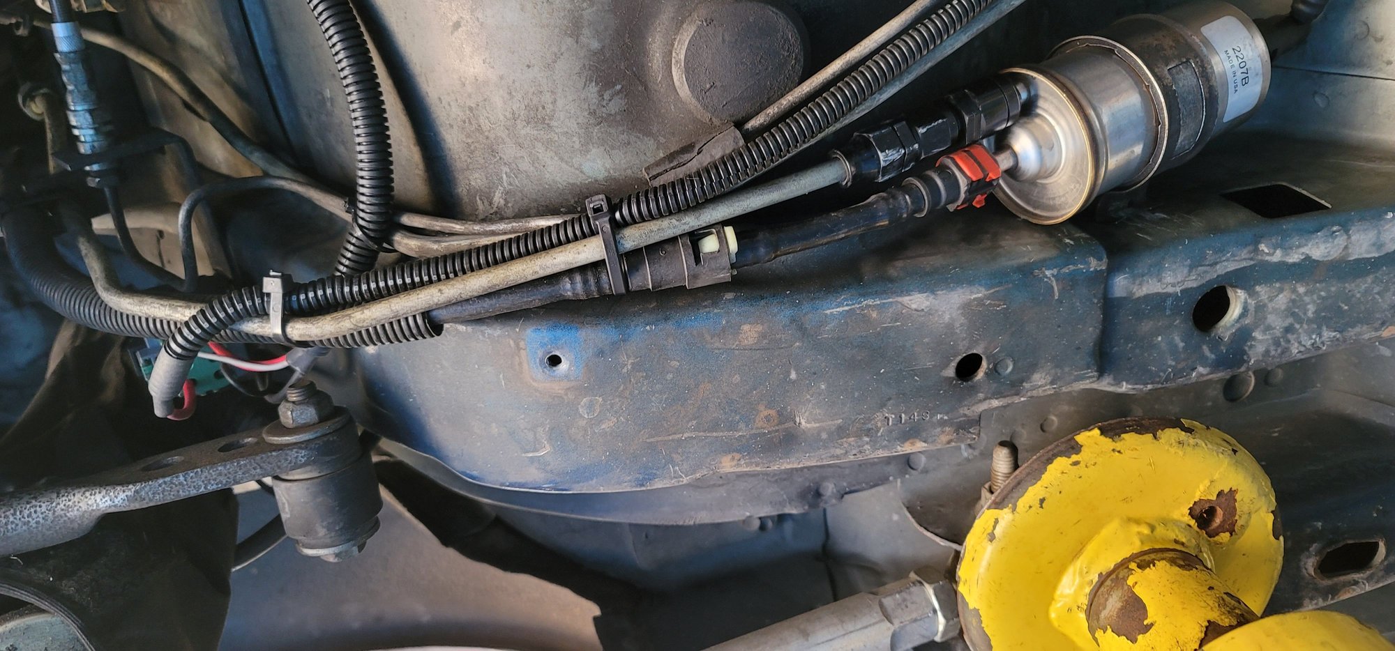

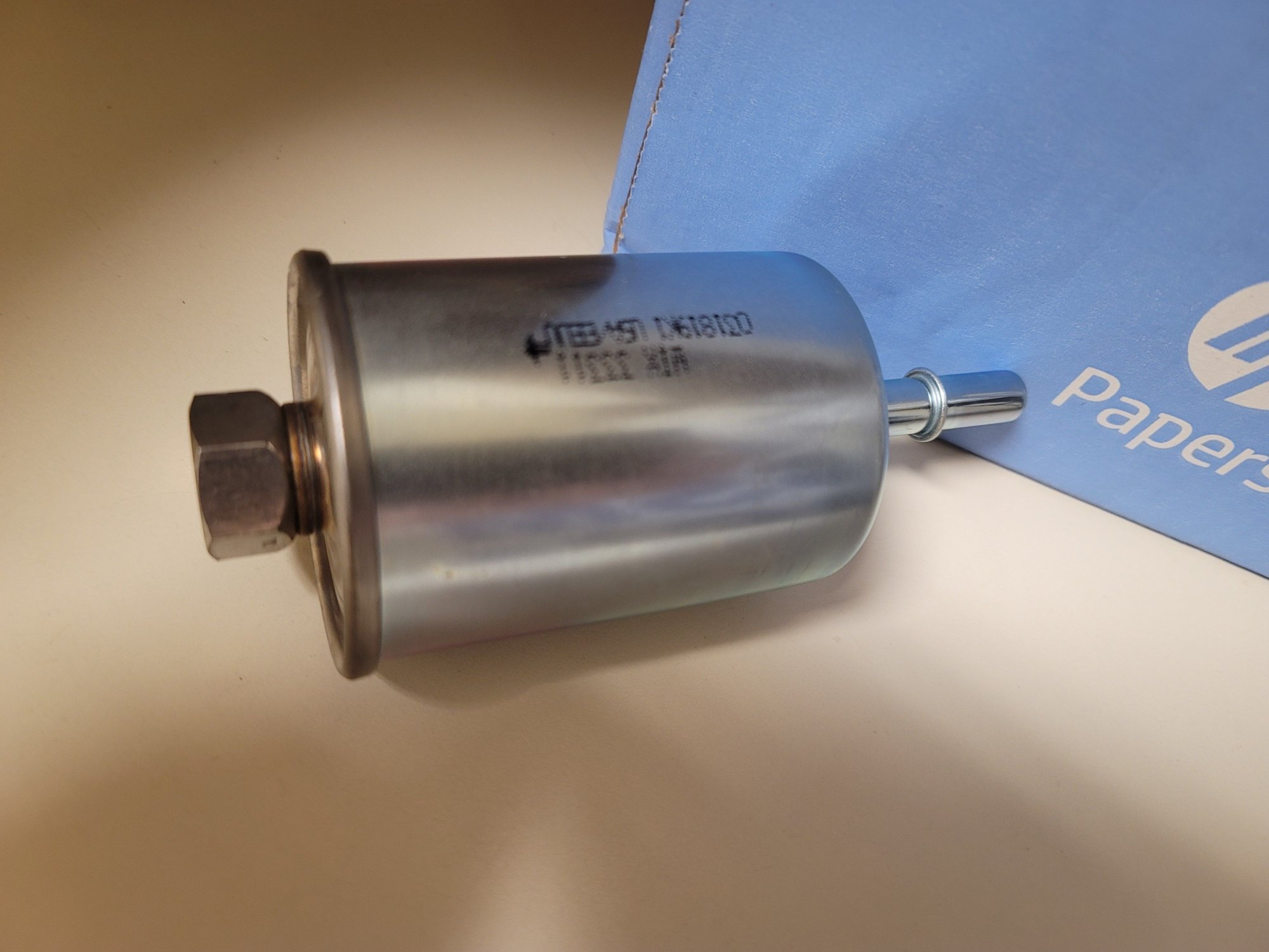

See photos of current fpr connections below. Easy to roll back to the OEM fittings to use the oem style inline filter? Or better to change fittings to connect to an inline aftermarket filter?
C5 fpr installed, currently using Wix 33100. Same design as the gf845 below.
ACDelco GF845 & original FPR purchased from WS6Store. Also tested with similar results
Oem filter design

Whatever it takes to plumb in a filter. About the most you'll get away with using the the C5 filter is a 255lph before it blows through the regulator. Now there guys out there that will say they have this and that using that filter. Well I've dealt with more than 10 that run a little above 60psi to as much as 80psi with 255, 340 & 450lph pumps.
So they were immediately changed over to an inline, 10 micron filter and an actual adjustable FPR. Problem solved.
You can use a OE style filter, they flow just fine. But I rarely use 3/8 or AN06 line. Most of my builds use AN08. But even on my wifes show car is just AN06 with a good ol Summit in line 10 micron filter with a very old FAST FPR that still works great.
