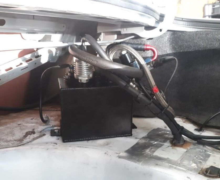

Surge tanks are a great cheap option I don’t see a lot of. Lets you basically keep a factory tank and oem pump and all oem sensors and fillers w very little modification. Mounted 2 AEM400 pumps ($150 each) my regulator/flex sensor/pressure sensor/filter etc all on the surge tank in the trunk with a single -8 line to factory rails up front. Bit of an octopus in the trunk, but cleaned things up in the engine bay a ton. 1/3rd the cost of the twin 525 setup above and pumps more fuel. I use the "evil energy" push lock fittings and hose on amazon.
