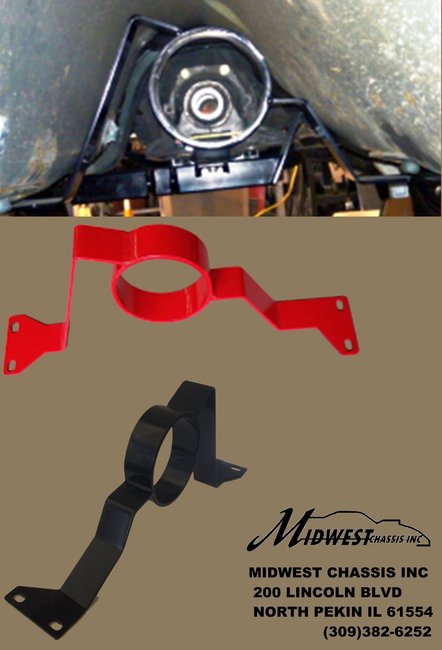

This is what ours looks like, you won't find a better fitting driveshaft loop on the market.

Thank you flintwrench69 for sharing your picture and answering questions. Looks great by the way.
These can also be purchased through our Ebay store. Look for midwest_chassis.
