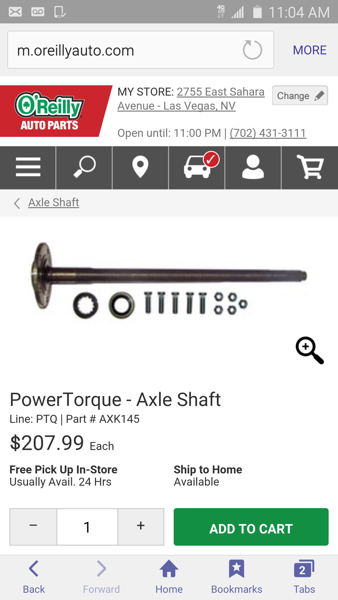

For the left and right axle shafts it's 200 with a 1 year warranty, it's comes with new seals bearing nuts and studs I'm not sure if the studs come pressed in already either way I'll be picking this up soon ,, is replacing these parts difficult?

Just get new studs and press the old ones out and press the new ones in. Unless your axles are messed up you are just wasting money.
