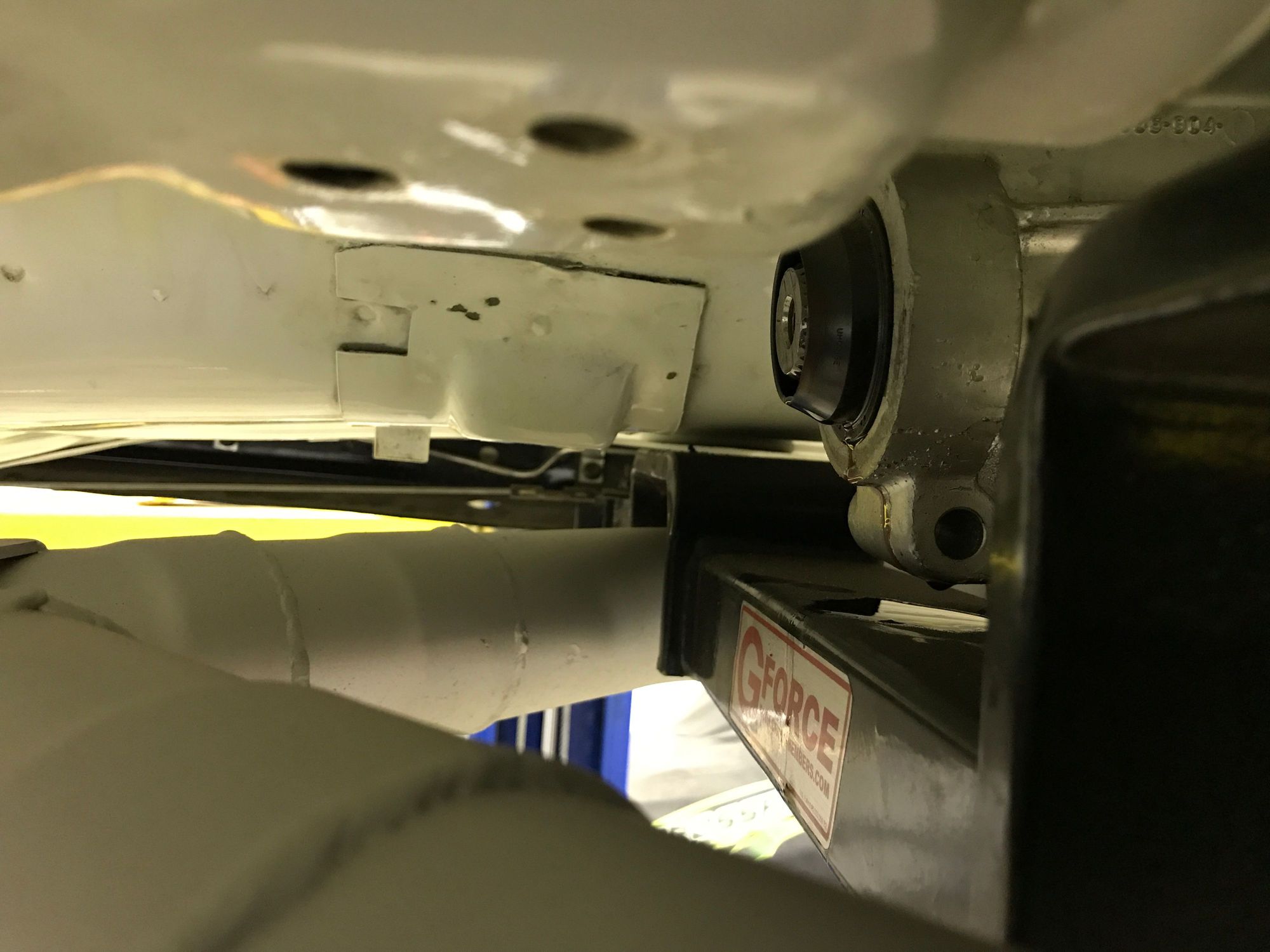

I went with a Mark Williams driveshaft and yokes for my 01 Camaro http://www.markwilliams.com/. I took out a steel driveshaft that was most likely what killed my transmission from previous owner it was a hack job install from some shop. But the Aluminum driveshaft I just got a month ago was a work of art from Mark Williams!! I went with the 3-1/2" 6061 Accu-Bond Driveshaft that meets SFI 43.1 specifications that is required for NHRA pro stock and competition eliminator classes. Yeah I know it was total overkill but could not be more happy with the attention to detail and amazing quality from these guys!!
A few cool things about the Accu-bond driveshafts is that they are made to order not on a shelf waiting for a close enough measurements order. There are NO welds on the driveshaft since they use a patented bonding process and they have everything in-house ready for every driveshaft (yokes, u-joints, clips, bolts, ect..). Every driveshaft is balanced and tested with YOKES installed so you get a true balance, I think they are the only ones that do this process. Plus you get a certificate listing the testing results which is cool and a nice piece of mind.
Attached Thumbnails Driveshaft recommendation-image1.jpg   Driveshaft recommendation-image2.jpg   Driveshaft recommendation-image3.jpg   Driveshaft recommendation-image4.jpg

That thing is a work of art! Its a little more then I'm looking to spend right now unfortunately.
