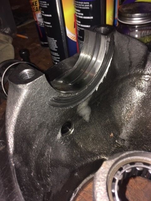

Also, regarding the Powertrax differential, the factory installed bolts on the Powertrax differential supplied with my 9" backed out and grinded against my differential case littering the assembly with debris. I ended up having the replace the powertrax diff, bearings and gears. So if you end up going with the Powertrax, you're going to want to make sure they applied locktite to all of the bolts before installing.
