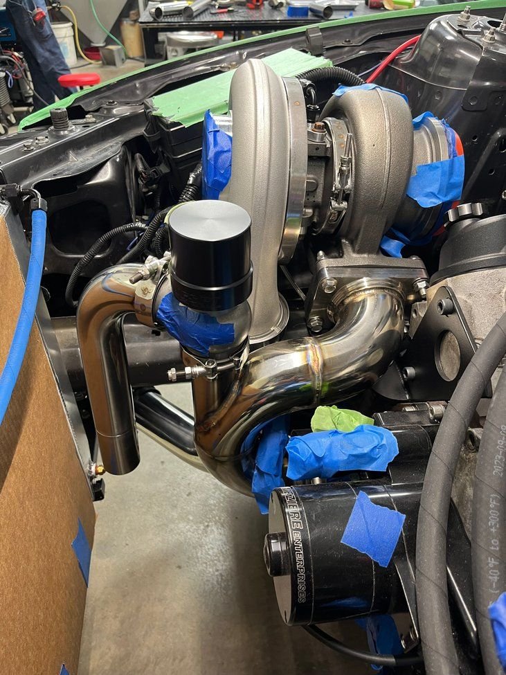

So for your engine, do you have forged pistons? You are going to gap your rings for boost? I have that same exhaust manifold and turbo you do. Here is how we mounted the turbo and made a bracket for it to sit on. I would do something like that rather than it just sitting on the manifold. Had to find a radiator with inlet/outlet that were both on the drivers side.
