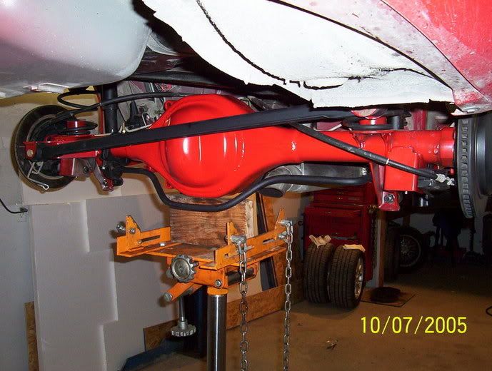

Finishing up the install. I wouldn't say this was one of the easier mods I have done. I used a lift & tranny jack so I had it easy that way. It's a moser housing with strange center section with 35 sline spool, I also had the housing shortened 2.5 inches per side. It has gone pretty smooth. Things I have encountered;
It appears that the stock driveshaft is going to be approximately a 1/2 inch short. I did not expect this I thought with the larger rear I would need a shorter driveshaft not a longer one.
I used a 1310/1350 conversion U-joint to mount the stock driveshaft which works but I am not sure what kind of U-bolt/bracket to get for mounting to the yoke? The holes are not threaded on the yoke like the stocker.
I had to pull the rear sway bar towards the back then tighten to avoid hitting the lower torque arm mount on the moser housing.

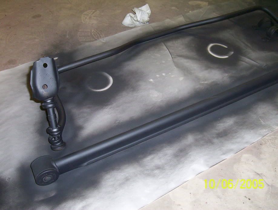

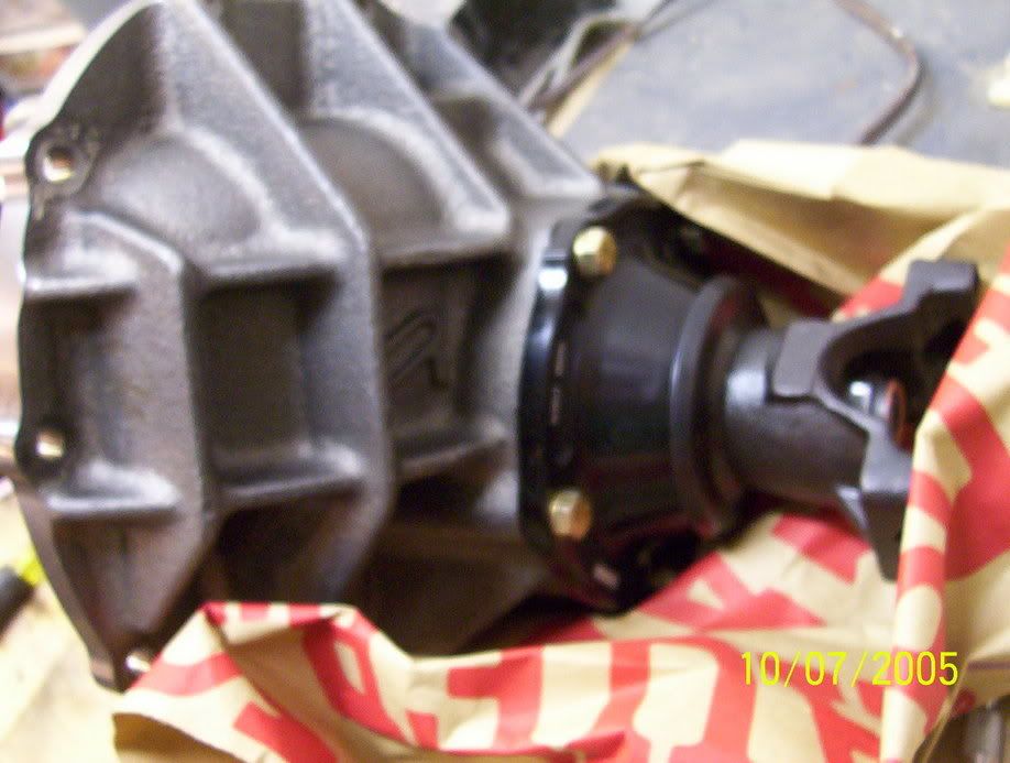

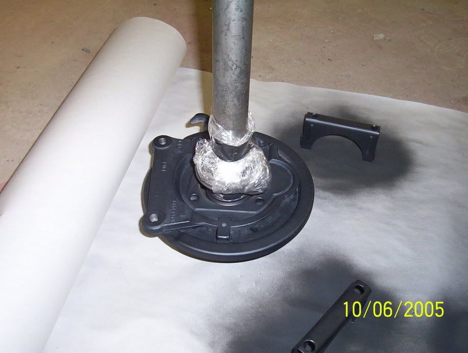

That's all I can think of right now. I won't be finished for quite some time because I just ordered the wheels that will fit this setup. Here are some pics, I removed a lot of parts to clean them and repaint.

I did the same install a while back on my camaro and my ds was about 3/4 shorter then what it should have been. I wound up getting a new one. Thats one BRIGHT red rear.

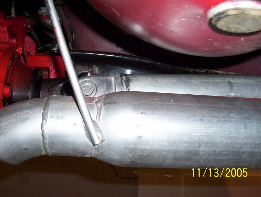

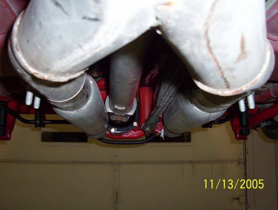

Sorry I haven't got back to you on the pinion angle question. It looks as good as the stock rear did?? It looks pretty straight to me. Here are some pics. This is with the suspesion extended all the way on a two post lift.

Thanks code4! Looks like you're doing some careful, good work. The driveshaft does look straight.
I can't wait to get going on mine, but I'll have to wait until spring. More nice pics!
