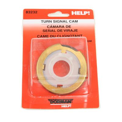

May just be the turn signal cam.
Does it click out of place when you straighten the wheel?
May also be some crud or water damage to the turn signal socket. Inspect that and clean.
Its not the flasher though, theres only one for the turn signals so the fact that you driver side works eliminates that.
