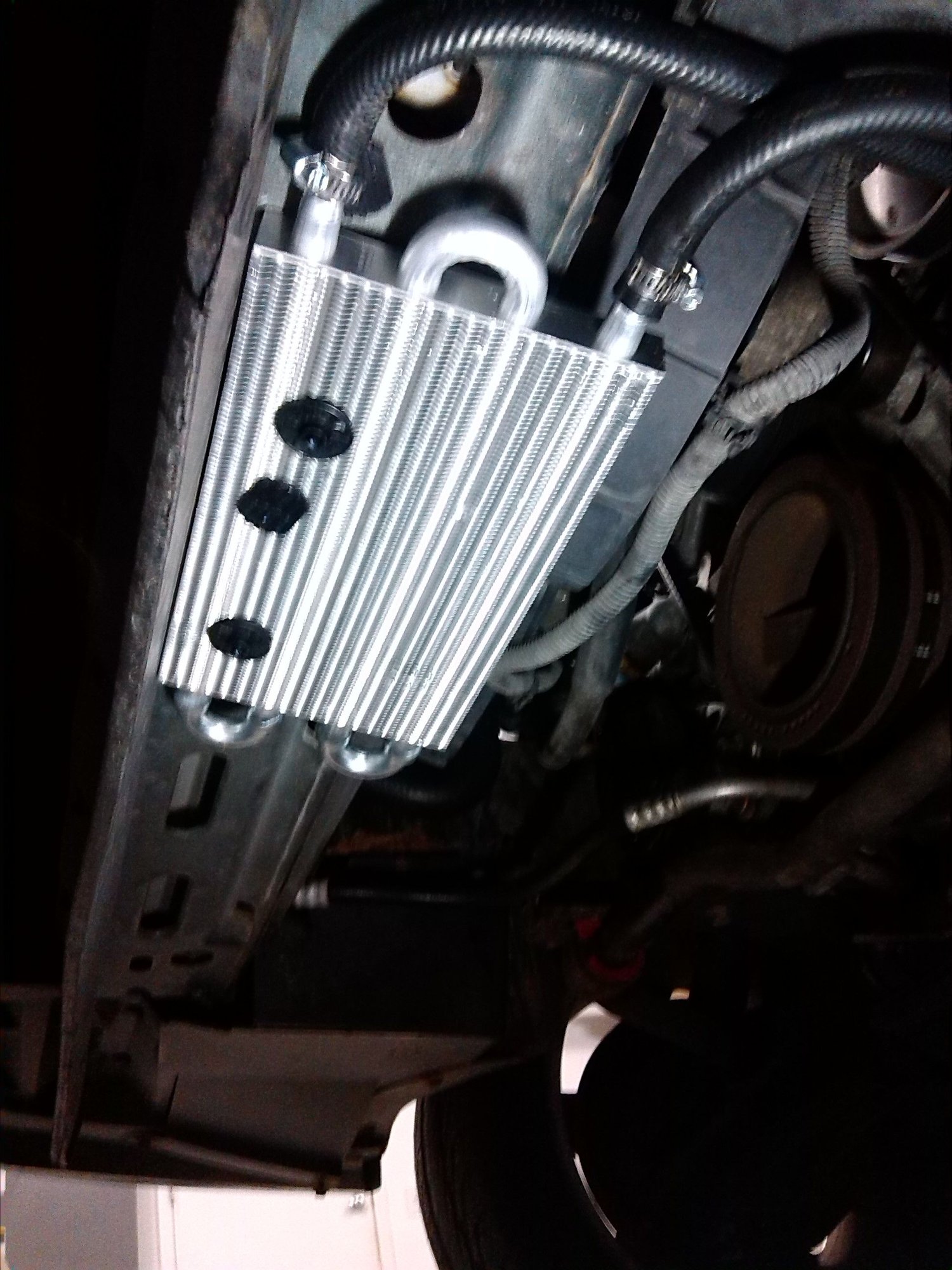

I would still keep a ps cooler but delete the stock unit. I mounted a transmission cooler under/behind the radiator and it cools much better than before. It cost me about $35 total for all needed parts.
