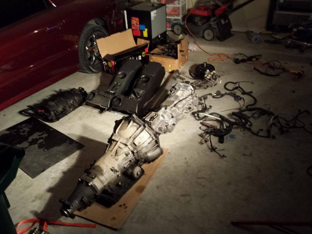

The engine harness is very easy to pull, it basically snakes around the motor down the drivers side of the rails down to the alternator, and from behind the intake back down to the transmission.
I think it took me a total of 30 minutes to do it. I don't think it would cause any electrical gremlins, you've probably got another issue you will find when you pull the old harness out to inspect it
