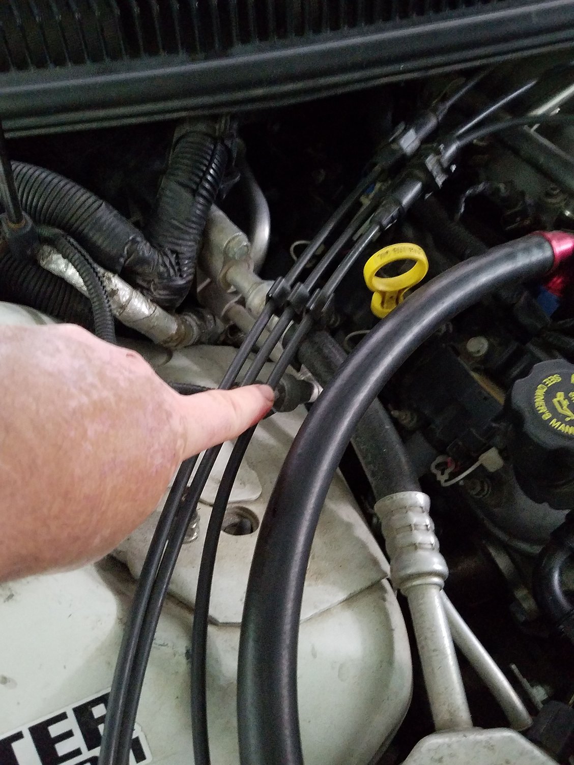

Is this it, located on the High side line?
Yep that is it!

parts stores list a Low Pressure and a High Pressure switch. I cannot find the low side.
I'd have to go looking around in the morning to see If I can locate another one. I know from pulling the engine I only had to disconnect the plug to the compressor and the plug from that pressure switch you have shown. Anyone else want to chime in on this?

Its a pressure Transducer (not a switch) and its on a shrader valved fitting. So you should be able to simply screw it off and screw it back on. OF COURSE ALWAYS WEAR SAFETY GOOGLES when working around refrigerants unless you like being blind. YOU should NOT touch this system with your limited knowledge in my opinion.

I believe it's the one on the line after the orifice tube you need to be dealing with. For safety by all means wear goggles and hopefully you can capture the refrigerant and not release it into the atmosphere. If you decide to release it into the atmosphere get a towel, sheet ,shop rags, whatever and wrap it around the line at the service port and depress the shrader valve to release the pressure off of the system. Keep that rag around there to catch any compressor oil that will be escaping from the system as it can get a little messy if not careful. Once you've done that go ahead and disconnect the line and replace the orifice tube and the pressure switch/transducer and reinstall the line. Be sure not to over tighten the line when reinstalling. Pulling a vacuum is recommended before recharging the system and it's a good idea to insert one of those small cans of PAG46 oil charge before putting in the refrigerant.
