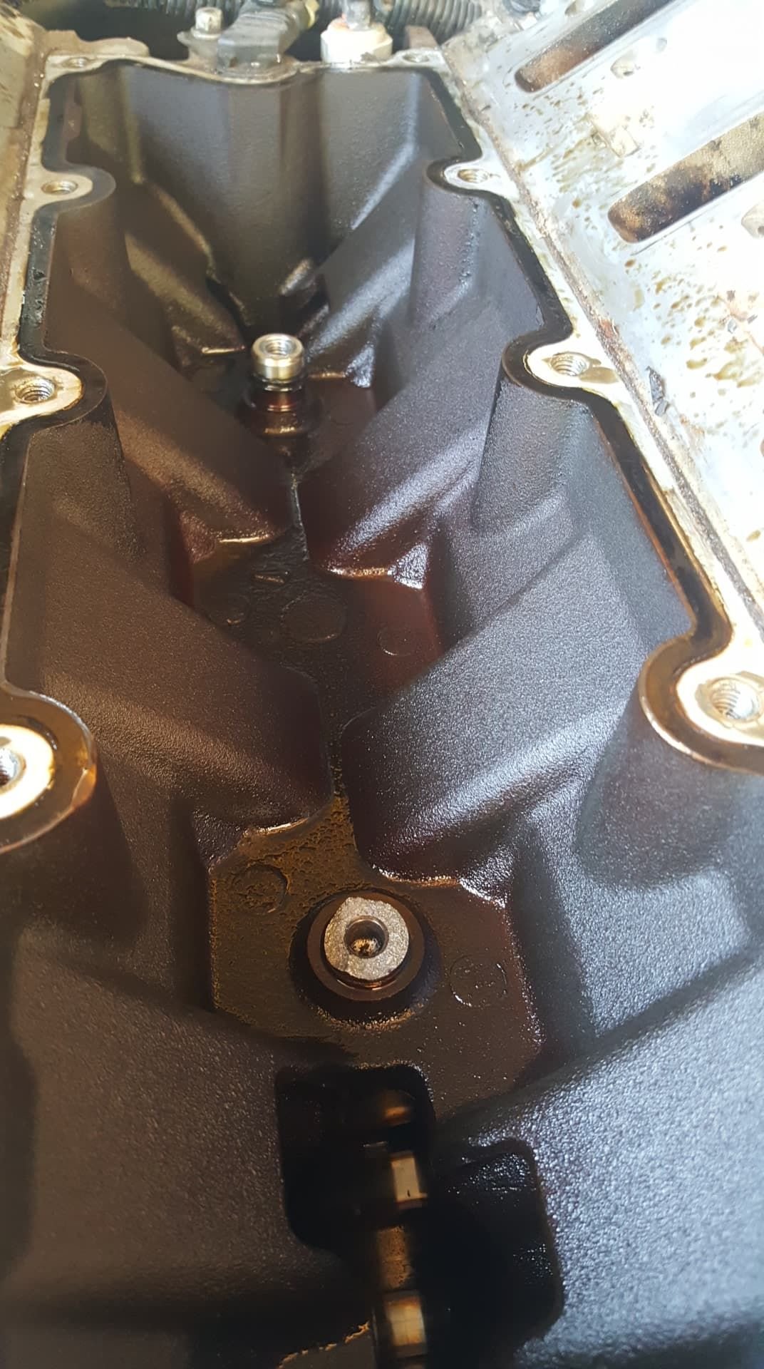

Is there a way to repair this whent to take off knock sensor and everything came off

torch around the sensor on block. Heat is likely the best method
Figure a way to get some form of tool (vice grips??) on the piece that is stocking out. Or dermal a slot in it and use a large screw driver to turn it
Heat around it quite a bit

Did you not see the picture? The block broke not the sensor.

Any one know if that's cast iron or aluminum it's an ls1?
Old Aug 15, 2018 | 07:35 PM
MY_2K_Z's Avatar
Posts: 2,144
Likes: 43
From: Houston
Aluminum

Maybe the following thread will be helpful.
https://www.corvetteforum.com/forums...ut-help-2.html
Posts 39-41
Please update, at least when there has been some sort of solution implemented. Thanks.

Thanx I will see what I can do I'm going to try tig weldimg it see what happens
My bad...saw 1st pic quickly on my cell phone and thought the threaded part of sensor broke off "in" the block, not the block casting

If you can't get it welded then I think you could relocate your knock sensors to the sides of the block like the GenIV engines. It would require lengthening the harness and I think drilling and taping two existing bolt holes.
I have heard of that on ls2 but I'm not sure if it will work with an ls1
I though I read a sticky about swapping an LS3/L92 into a '98 - '02 Fbody with one option to drill and tap the gen 4 block and install LS1 knock sensors. I think as long as it's secured to the block it should sense knock, regardless of Gen IV or Gen III. I hope someone can correct me if I'm mistaken.
Edit: here it is:
https://ls1tech.com/forums/generatio...02-f-body.html
From thread,
"-Knock sensors from your LS1
-Drill & Tap block 10mm x 1.5 for knock sensors same as LS2 swap
-Knock sensor extension harness (katech or racetronix)"
Hopefully my idea will work for you if necessary. Good luck.
