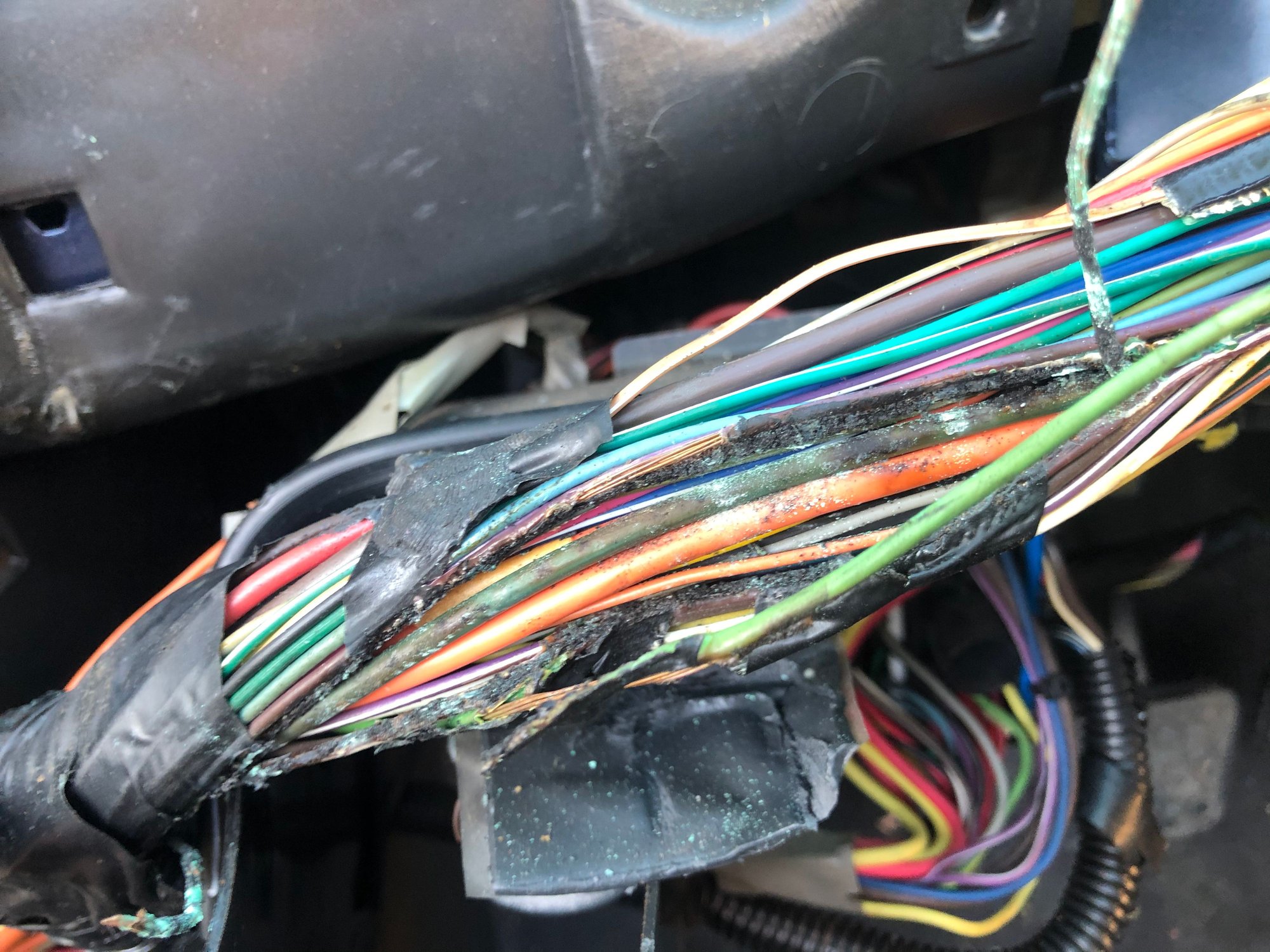

Old May 3, 2020 | 08:55 PM
RBD_305's Avatar
Joined: Jul 2013
Posts: 74
From: Miami, FL
Small update to the problem. Somehow the cig lighter wire burned up pretty good. The entire wire from the fuse to the cig lighter was melted and burnt. It also heated up some other wires and melted the plastic off them as you can see. I think this is what caused my problem. One of these wires is hot (12v) with ignition is key on position and it’s powering the starter wire.
Old May 3, 2020 | 10:05 PM
wssix99's Avatar
Save the manuals!
Joined: Dec 2007
Posts: 12,967
Likes: 389
From: Chicago, IL
That must have been one hell of a cigar...
I'd also give the fuse box a good once-over. The fuses are supposed to keep this kind of thing from ever happening!
Old May 3, 2020 | 10:52 PM
RBD_305's Avatar
Joined: Jul 2013
Posts: 74
From: Miami, FL
Hahaha! Yes i agree, well the previous owner was a smoker. So he used the cig lighter alot. I think what happened was it had a short somewhere and he just jumped the fuse outlet for the circuit instead of running a fuse! Oh well, I'll be repairing most of the harness anyway and deleting what I dont need.
I'd like to also say i appreciate everyones efforts to helping me find the problem! Thanks.
