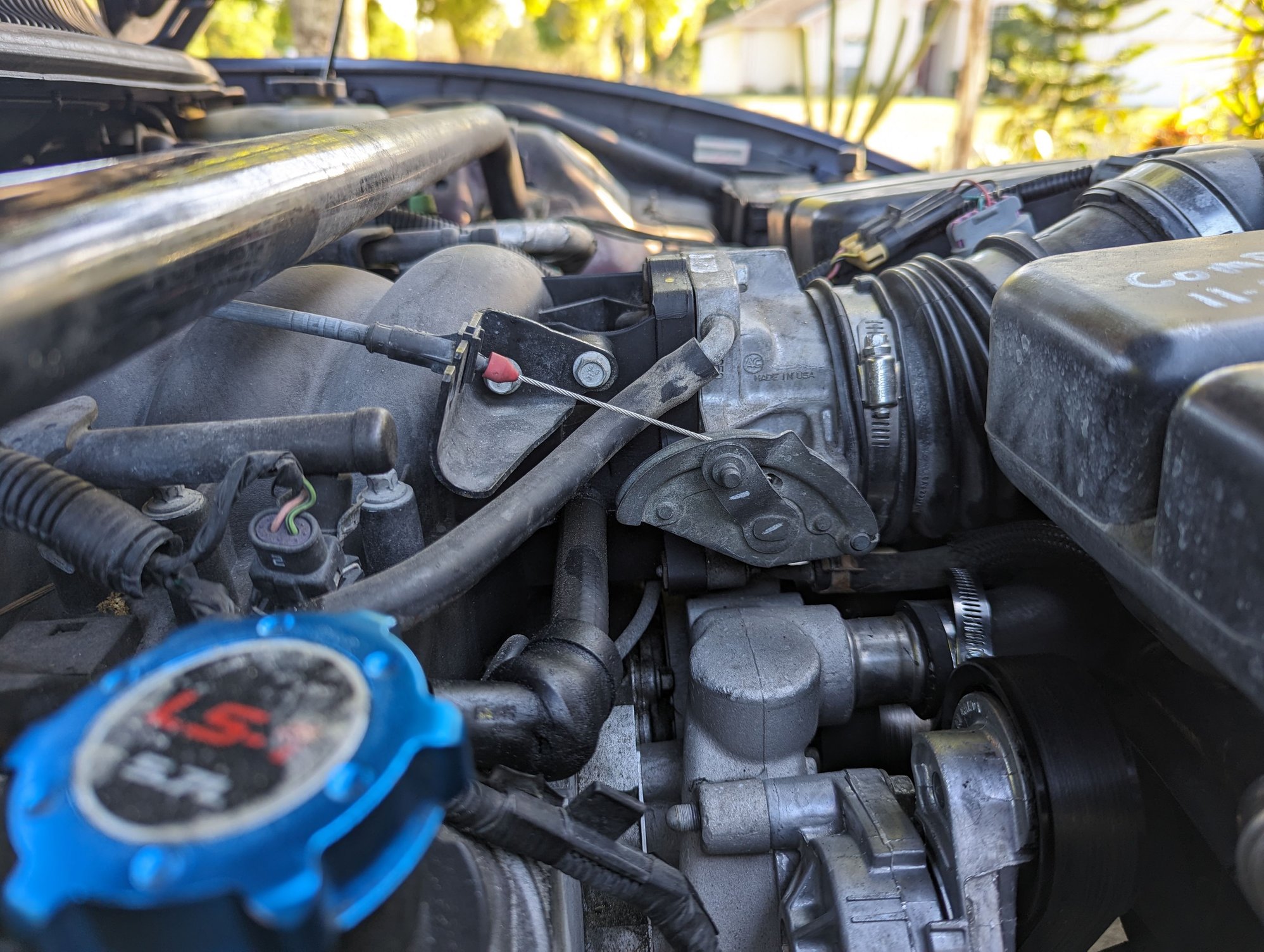

It moves smoothly, no issue at all. I have noticed I need to be driving at least 20 minutes before the starts to happen, and I have not been able to replicate in in the drive away. Busy day, did not get to take pictures Will be getting one tomorrow, of the PCV valve. I did have some work done a couple weeks ago, to replace the tension pullies. I do not remember the PCV valve being in the condition I saw it in. Again will post tomorrow.

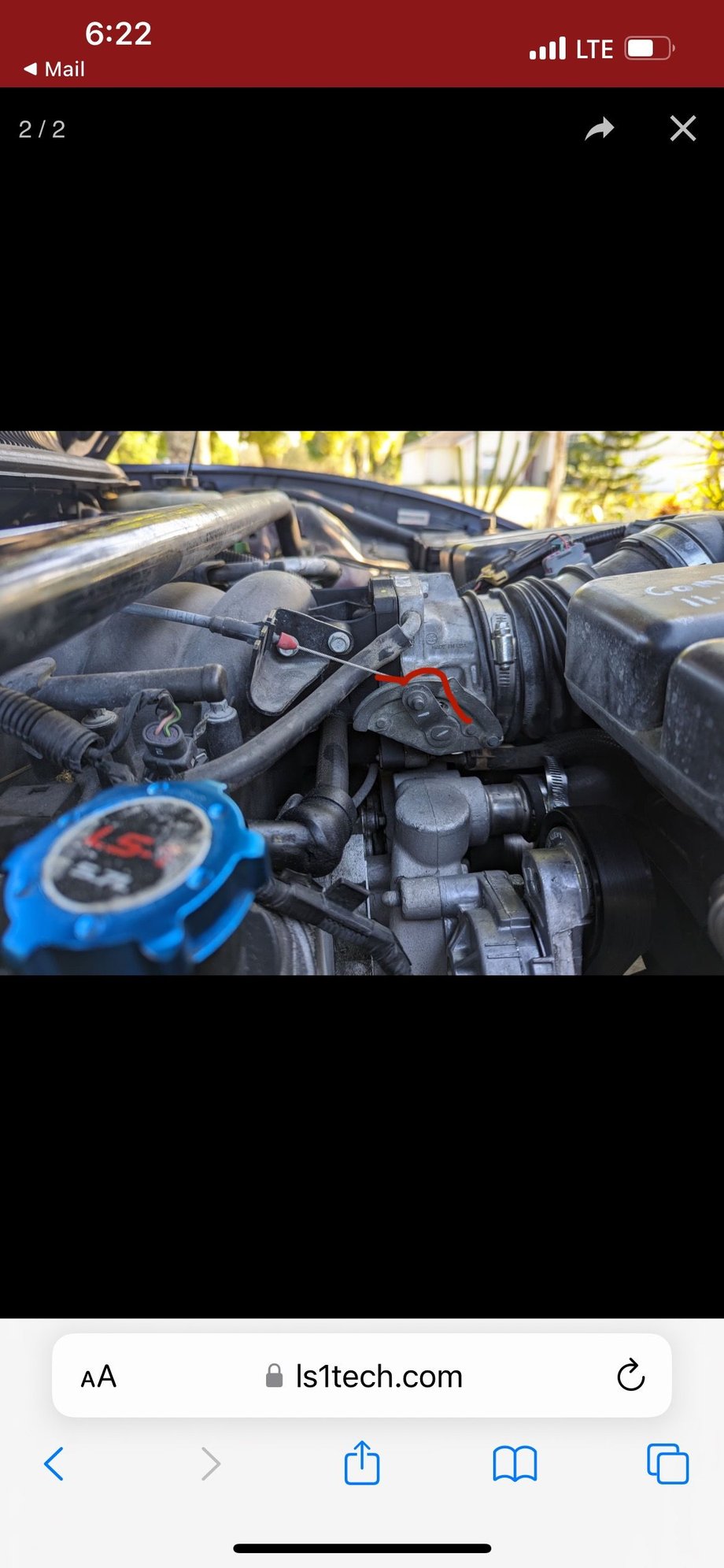

The throttle has hung on my mustang before when I floored it real hard & fast abruptly. It had just enough slack that when I floored and it jerked the cable and the cable made a loop and it came out of the groove it rides and it got hung on the outside of the bell crank causing the throttle blade to get stuck open. I didn’t realize why it was hanging until I had someone floor it repeatedly rapidly while I watched it and I saw it coming out of its grove. The motor was off while I was doing this by the way. To remedy it I used some zip ties as spacers to take some slack out of the cable on the pedal end. New throttle cables are obsolete for that car so zip ties it is.
Something like this. The red line is the cable. Have someone floor it rapidly and see if the cable stays where it should.
I have to been able to replicate the issue in the drive way. Each time it has happen, has been in/at inconvenient times and location. I plan to pull over and stop and look at it next time. Been driving the truck that last week due to Dr Appt's I can not miss.

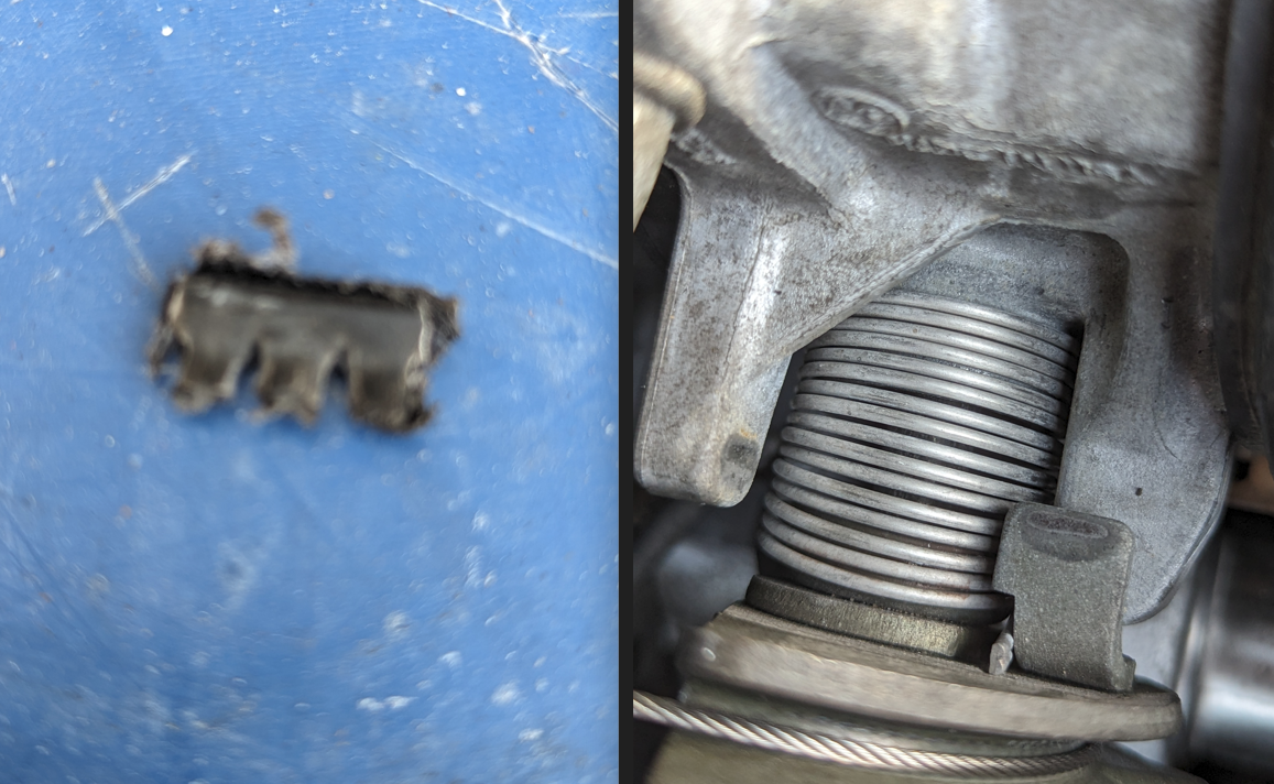

Well... I was doing this. While I was there, I decided to clean the TB for the second time. As I was brushing it, this piece of plastic, same out.
I do not know if I should feel Dumb or this is just one of those damn things.
At least my 10 minutes drive life seems to be good.....
On a positive side, I got preventive maintenance done, that was probably LONG over due.
Thank you all for everyone's help.
