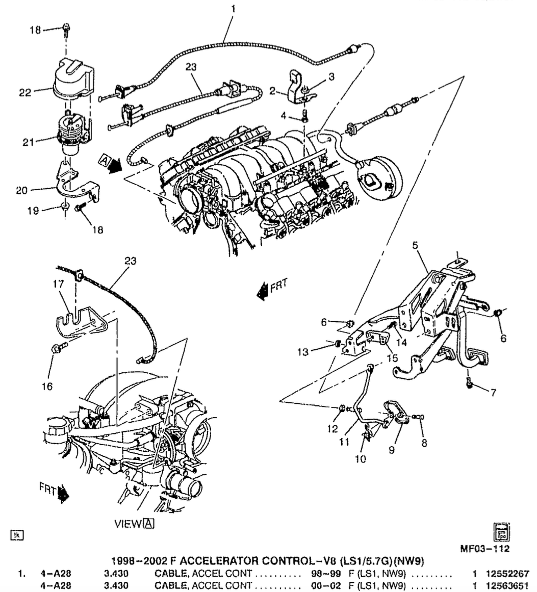

The pedal cable has no such adjuster; it's just a fixed length. I've confirmed in the factory service manual: in the accelerator cable replacement procedure, there is no mention of any adjustment, nor is any adjuster visible in the corresponding parts diagram (it's the cable labeled "1"), whereas the adjuster is plainly visible on the throttle cable ("23"):
I've adjusted the cruise and throttle cables correctly, but the pedal cable is about 1-1.5" too long, and as such I am unable to get to wide open throttle by pressing the pedal to the floor.

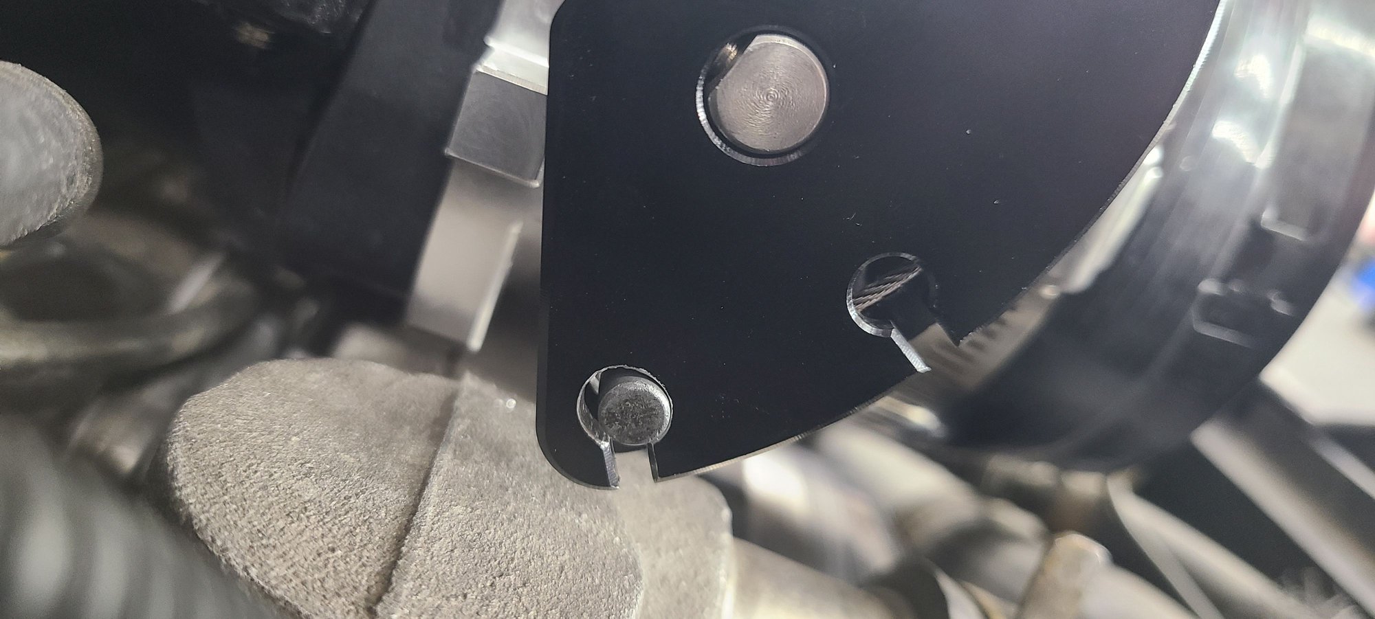

I may had the problem of not being full wot with my last TB but not being fully rest on the ajustement screw is new with the 102mm chinese TB. I figure out by opening a little bit the hole where the cable hook I was able to rest it on the screw and get 97% at wot. This is what it was missing in the cable adjustment to get close. For the tuning, I'll know this week at the dyno.
I’m having trouble understanding how opening up that hole allowed the throttle to open farther. Seems like it would have done the opposite?!
Yes, it's the opposite bit it's what Ineeded. When the cable is hook on this hole on the TB I'm able to get full opening, like 97% but when a release the pedal, I'm at like 1% opening. The adjustment is the max on the cable so I'm unable to get it closed completely on the screw. By opening the hole, I was able to get it sit on the screw and adjust my opening at idle.
