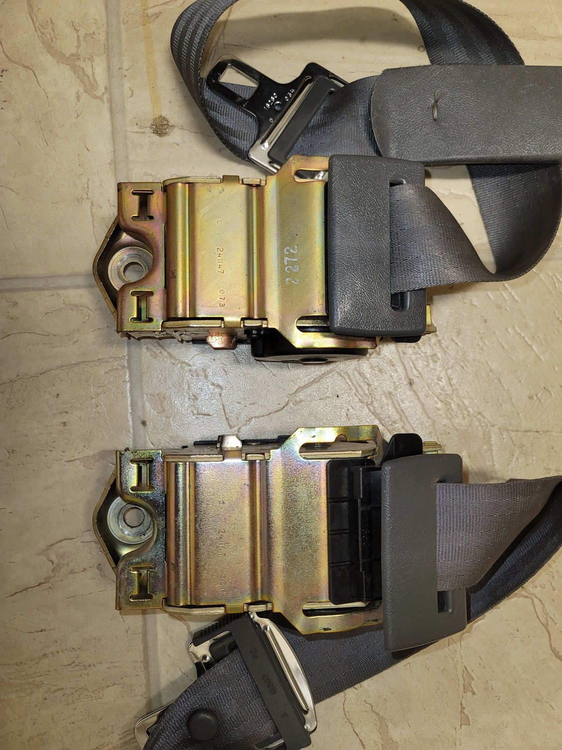

I found another set of front seat belts in storage. I think these were the originals, and I removed them because the plastic on the latches had broken off. So I could trade a mechanical issue for a cosmetic issue.
Front seat belts
Front seat belts
