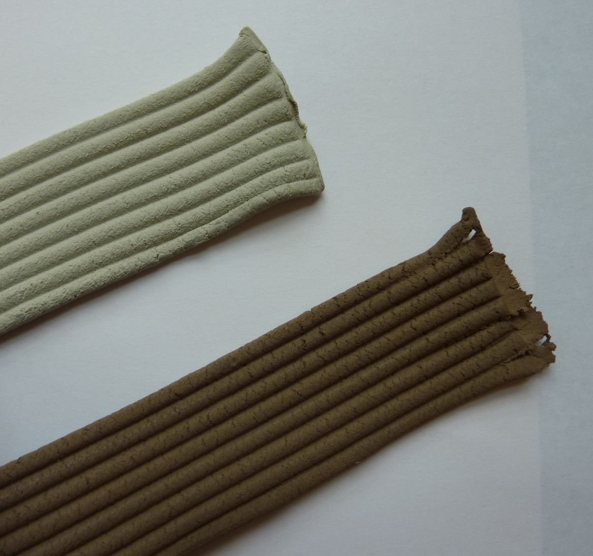

And here is what the product looks like as you unroll it (again, you can build it up and form/cut/rip as needed; it's very workable and will stick to itself to form whatever shape you want/need):

Sorry for replying later than I wanted. Between cold weather and job, I haven’t had a chance to get back out there. The rope caulk did a great job since it was flexible. The firewall hole is about 1.5”x3” so I needed quite a bit to fill the space. Once I get the car running (who knows when) I’ll need to report back and let you know how it held up. Thanks again for the assistance!
