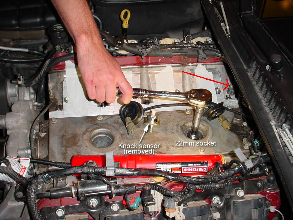

I just went back to the LS1HowTo site and it is misleading. Picture #5 where the manifold is coming off shows the coolant line in place over the valley cover but the rest of the shots shows the blockoffs are already installed and make no mention of them. See the back of the heads pic #9, you can barely see one of the blockoffs already installed. Check out that sites other article about switching to an LS6 manifold for a better description of those pipes and how to convert them. http://www.ls1howto.com/index.php?article=5

I don't care for the way he used the same front pipe part to used in the back also. Check out his other install link that shows the Intake Manifold swap http://www.ls1howto.com/index.php?article=5 , it gives you a better idea of how the new lines will work and the individual part numbers. If you notice in the pic I attached, he had to rig a rubber hose and a bolt to block the back pipe because it has nothing to connect to. Just one more place for a possible leak IMO. The kit you buy from several sponsors includes the 2 head plugs to be used in the back to block those holes off because you won't be running a pipe under the manifold connecting the 2 together anymore. The kit cost about $50 and includes the front pipe and the 2 back plugs.
