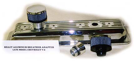

Hey Al,my Metco breather does screw into the neck. Just remove the cap!!Maybe its their new design.

Hey Paul, never heard of one like that, any pics? Thanks

Sorry Al, I dont have the capabilities to post pics. Ill tell ya though, Im very pleased with these mods, major reduction in oil consumption!

Got it Paul, mailed you back but unless I'm missing something that's what everyone sells. I'm asking Todd if they can make just a breather that replaces just the oil cap not the whole unit. Let me know if I'm missing something here. Thanks

Al, did you see the billet piece sitting next to the breather. The filter goes on the billet piece and the billet piece screws right on the oil filler neck. You just take your cap off and screw the piece in. Ignore the picture of the valve cover. That billet piece screws right into the filler neck.

Paul, I understand what you're saying but I'm confused why people say you need to remove the filler neck, I'm going to wait and see if Todd is going to make a breather before getting the Metco breather.
Here's the link of the breather your talking about, and you're saying the peice next to the breather is what you replace the oil cap with? http://www.southfloridapulleyhq.com/...l_breather.jpg

Thats correct, you simply remove the oil filler cap and screw it in. No need to remove the oil filler neck.
