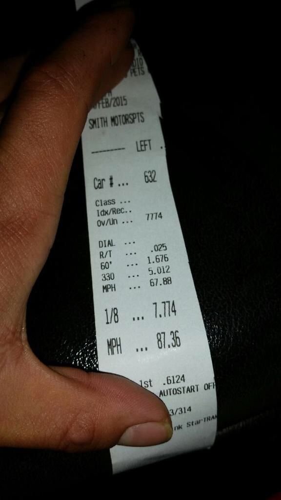

This was Sunday, spinning a little looks like I need new tires lol

I'm hoping I can pull a 60' like that next time I go out

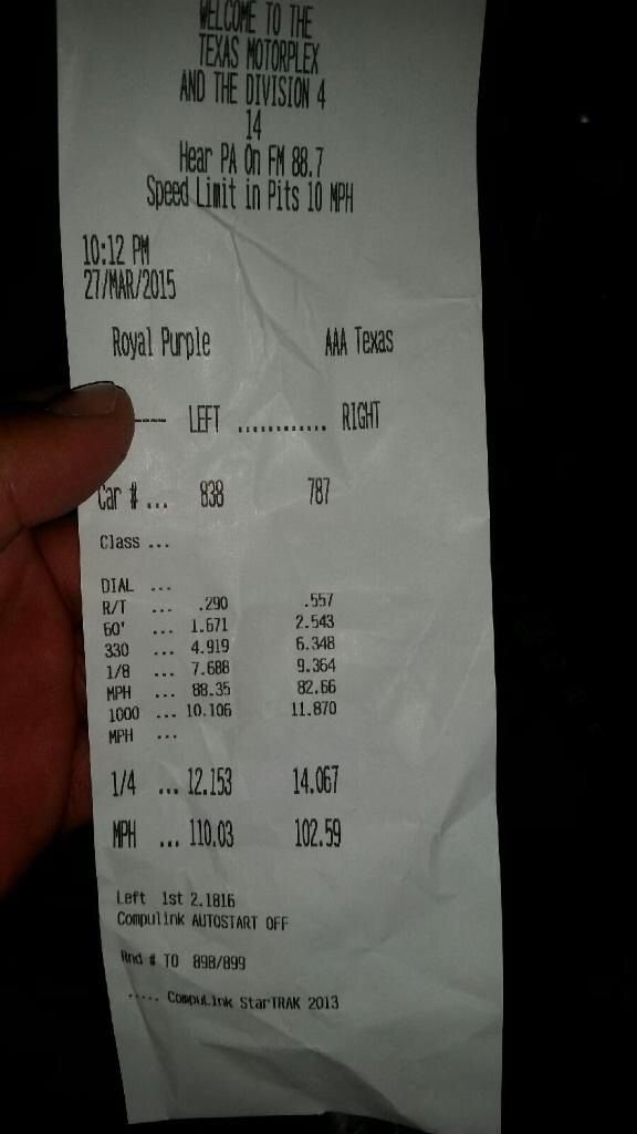

Bump****
Well took the car on Friday and for it to spin out the hole the car did freaking good!
12.15s on a 2000 SS going to do a BMR suspension change and maybe an intake manifold and get as deep into the 11s as we can lol
Car has:
Ported throttle body
Old broken lid
1 7/8 TSP headers
3" x pipe and duals
Under drive pulley
3600 circle D
15s all the way around
26" M/Ts
Next step:
BMR K-member with upper/lower control arms
BMR drag suspension level 2
After market intake manifold
Bigger throttle body
A nicer lid
Ram air scoop
Rearend (unknown) 3:90 gears or 3:73s ???
Still working on ideas

very nice! just doing the suspension should get you in the 11s dont you think? Better set-up and you will drop some weight.
