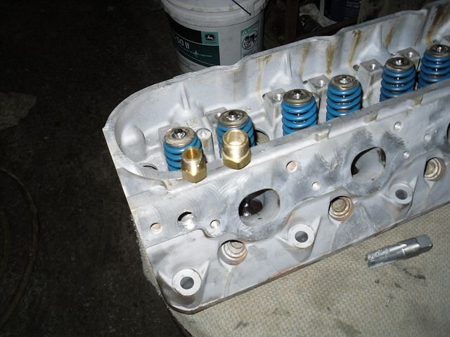

Old Oct 7, 2014 | 01:41 PM
CattleAc's Avatar
Joined: Dec 2007
Posts: 1,644
Likes: 429
From: Dakota Territory
Like this...

Old Oct 9, 2014 | 09:56 PM
Kacuziken's Avatar
Joined: Jul 2014
Posts: 23
Originally Posted by CattleAc
Like this...
Did you have to drill it out first or just run a tap in it?
Old Oct 10, 2014 | 03:43 AM
6t7gto's Avatar
Joined: Nov 2004
Posts: 92
3/8 NPT goes right in.
Old Oct 10, 2014 | 12:58 PM
CattleAc's Avatar
Joined: Dec 2007
Posts: 1,644
Likes: 429
If I remember correctly, I bored it out slightly before I tapped...
