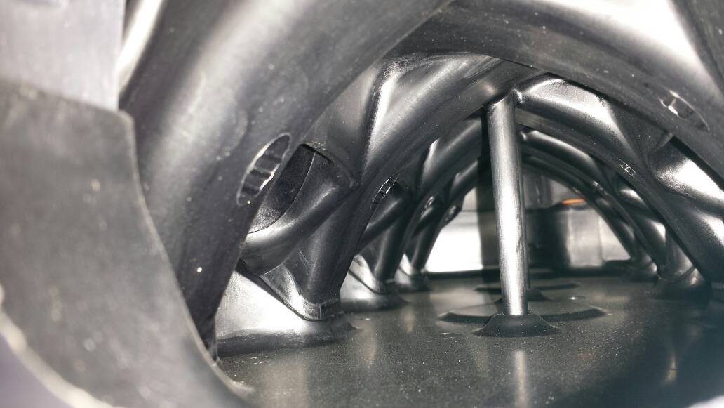

Originally Posted by dreadpirateroberts
dropping in from ls1gto.com
got some pics of the plenum on one of these dorman intakes.
enjoy.
I wonder how sealed the upper shell is to the lower? You can see the orange seal in the very back seperating the two.
Maybe it's just bonded in a couple of places and once the intake is on the car it compresses the seal and sucks the upper shell where it needs to be?
It would be cool if someone would tear one apart unfortunately like me I don't want to spend money and ruin something that I can buy for $50 more....
Dorman said the shells are vibration welded together. I'm leaning towards that orange bit actually being a MAP sensor seal.
Guess you missed this...
Originally Posted by Schmittybuilt
Guys, I was lucky enough to see the piece that was dyno'd in that test. I was excited when I first saw it and somewhat disappointed when the results came back as I had hoped it would be as good as an LS-6. To answer some questions: Yes it is a little rough as produced, but it is also designed as an OE replacement part. Some flash removal and maybe some work to get the entrances close might add another 5-7. Also it is heavily glued together and I do not believe it would come apart without destroying it so porting would be difficult to say the least.-Mike

TT427's Avatar
Joined: Dec 2009
Posts: 372
From: Florida
It was said that it was friction welded, and a quick pass with a dremel it would come apart, then rtv black it back together. Where is the adhesive coming from?
