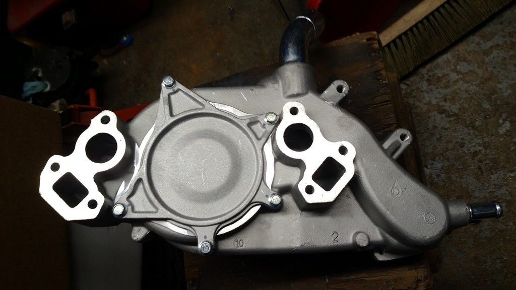

OK folks, I've received the pump for my truck.

Looks nice. Never heard of these

Get installed? Any difference?

I installed it today. I don't expect to see any difference because the thermostat keeps the engine at 210. I'll know when I'm stuck in miles of traffic on a 95+ degree day with my A/C blasting.
Interesting working on these trucks....
