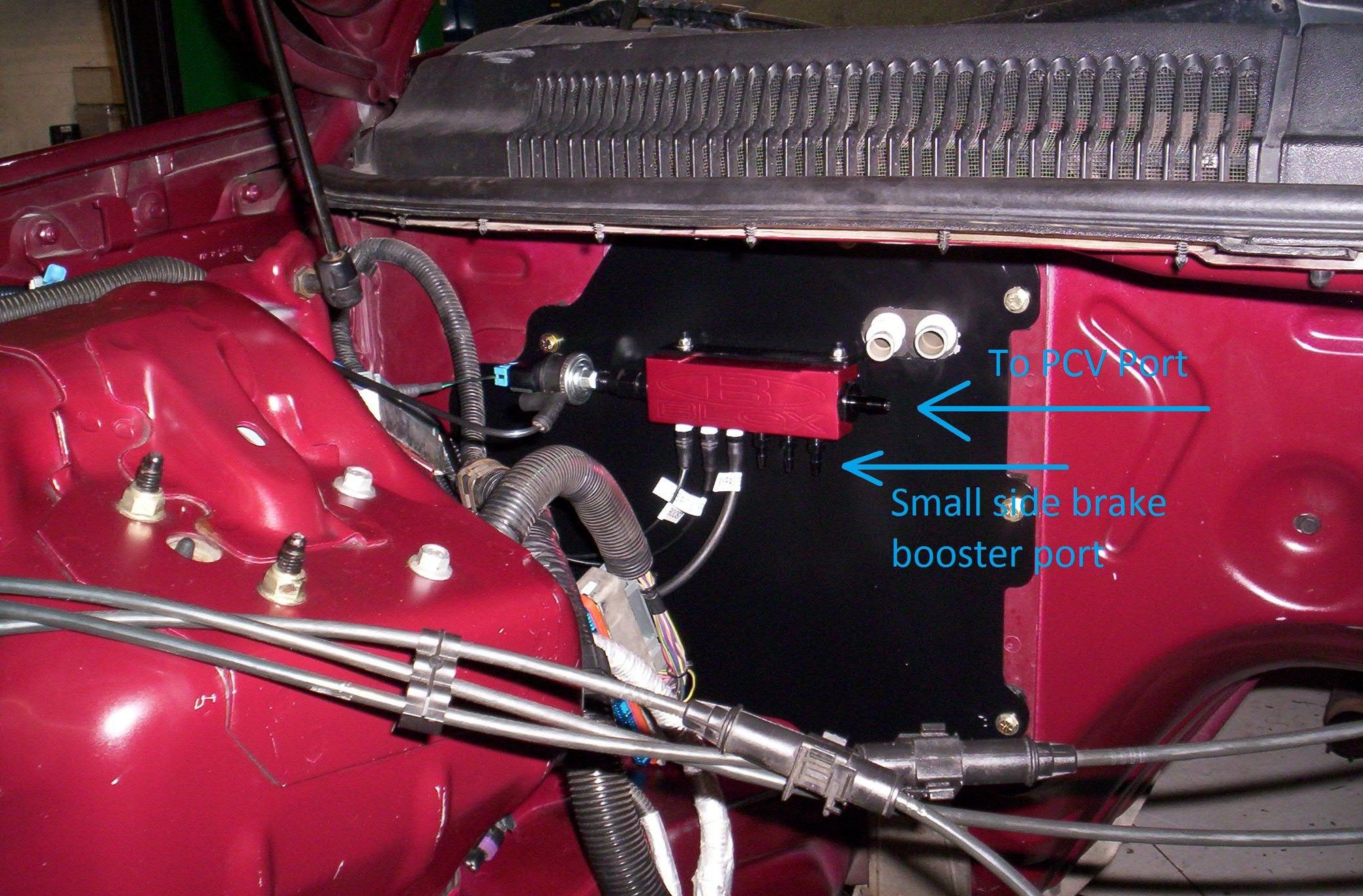

I should have asked how many vacuum operated systems do you have on the car ?
For example, I have 5 vacuum / pressure operated systems. Hobbs switch, by pass valve, boost gauge, HVHC trap door, and meth injection. So I bought a manifold and plumbed everything to that. I feed it with the HVHC port you were asking about in your first post, and the PCV port on the front. Then I capped the EVAP on the drivers side with a silicone cap. Here's getting started...

nice man!

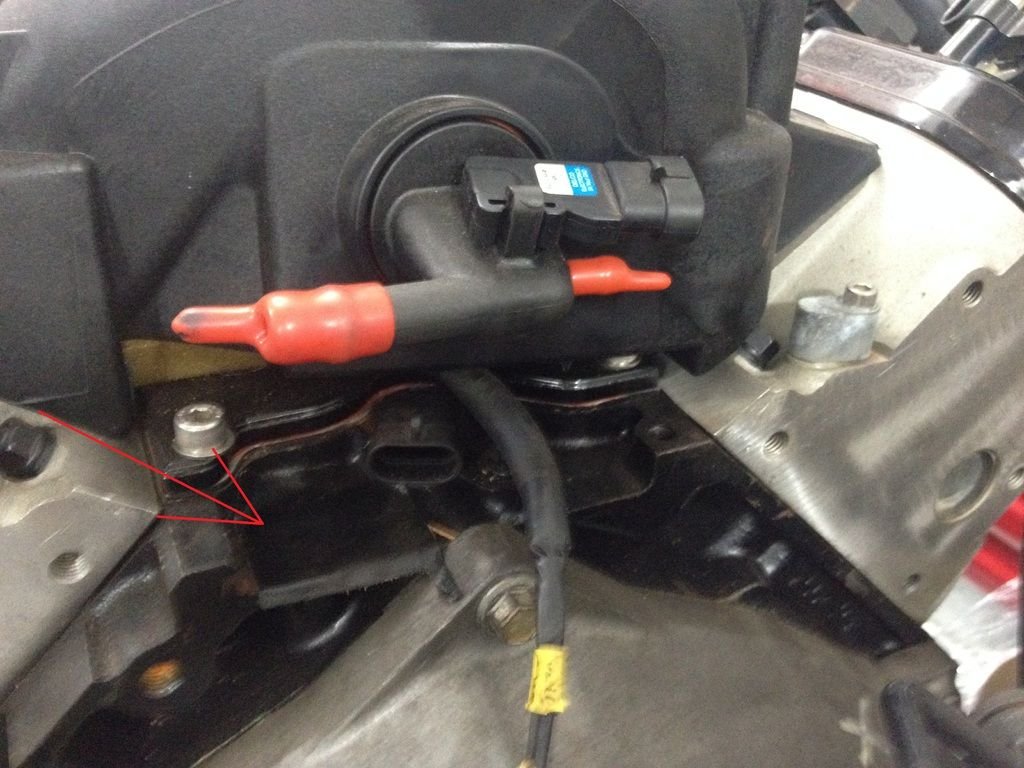

here you could see in my engine the oil lines from the exit in the rear of the block to feed turbos
here the exit in the rear cover by blacktape before I assembly the feed lines, using a Y fitting
Old Jul 29, 2015 | 06:59 AM
conan's Avatar
Joined: May 2004
Posts: 6,492
From: Back in the Burg
The pic above with the red arrow is the oil pressure sending unit hole. Don't see why that would be a problem to use for feeding oil to your turbos.
