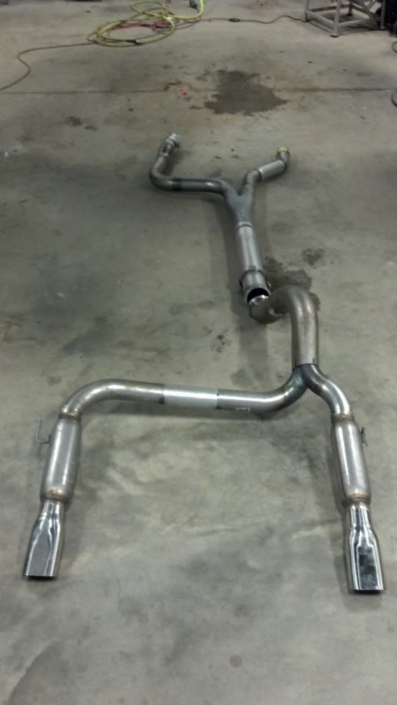

Mine turned out okay, but I'm biased.
https://ls1tech.com/forums/generatio...-ford-9-a.html

Those are nice!
Something like dckmn's setup is somewhat what I had in mind. Except I would stay 4" all the way with a Borla XR-1 and a hidden tip.
I had one similar to the other one with the cutout on my last car. It worked ok I just want something that works well and sounds nice without needing a cutout.
