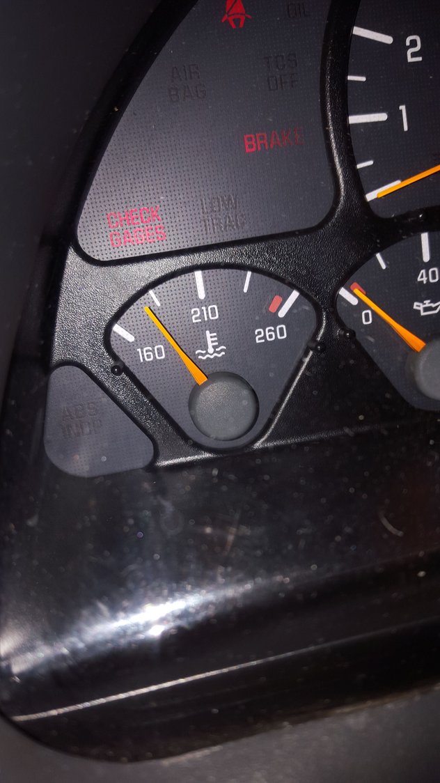

I'm running a 180 currently. Before I had either a 160 or a thermostat that was stuck open when I bought the car. I almost thought the gauge was bad because it would barely even move.

With the 180 this is where m gauge stays at now. I don't know why my car runs so cool.
That looks like its stuck open. Is the ECTS working properly?
Coolant senor is new. 180 t stat is new. I replaced them because the gauge would barely come off the peg at 160. It had a Motorad t stat before and I was just guessing it was a 160. Now that it has been replaced with a 180 it runs at the temperature pictured above. I actually used to think the fans didn't work because they never kick on. They work fine it just never gets hot enough to kick them on unless I let the car sit and idle for a good while.

Fwiw I know how a t stat works and I'm sure my old t stat was stuck open. But what would make my car run cooler than normal? I'm baffled.
I think a aftermarket temp gauge is in order I'm not so sure that the factory gauge is trustworthy or even operating correctly at this point.
Fwiw I know how a t stat works and I'm sure my old t stat was stuck open. But what would make my car run cooler than normal? I'm baffled. I think a aftermarket temp gauge is in order I'm not so sure that the factory gauge is trustworthy or even operating correctly at this point.
I thought to suggest the gauge might be off. I had a camaro do the same thing. It would show 165 on the gauge and be closer to 200
Mine reads exactly the same as yours
Ya, mine reads exactly the same but with a snap on diagnostic scanner it says it's running at 188 degrees when the fans make there first cycle iirc

Isn't that middle line 185 degrees? I think your car is normal and your gauge works fine Zach for a 180 stat
