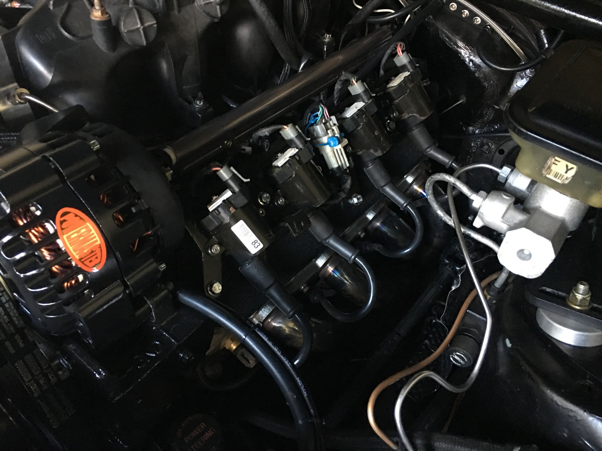

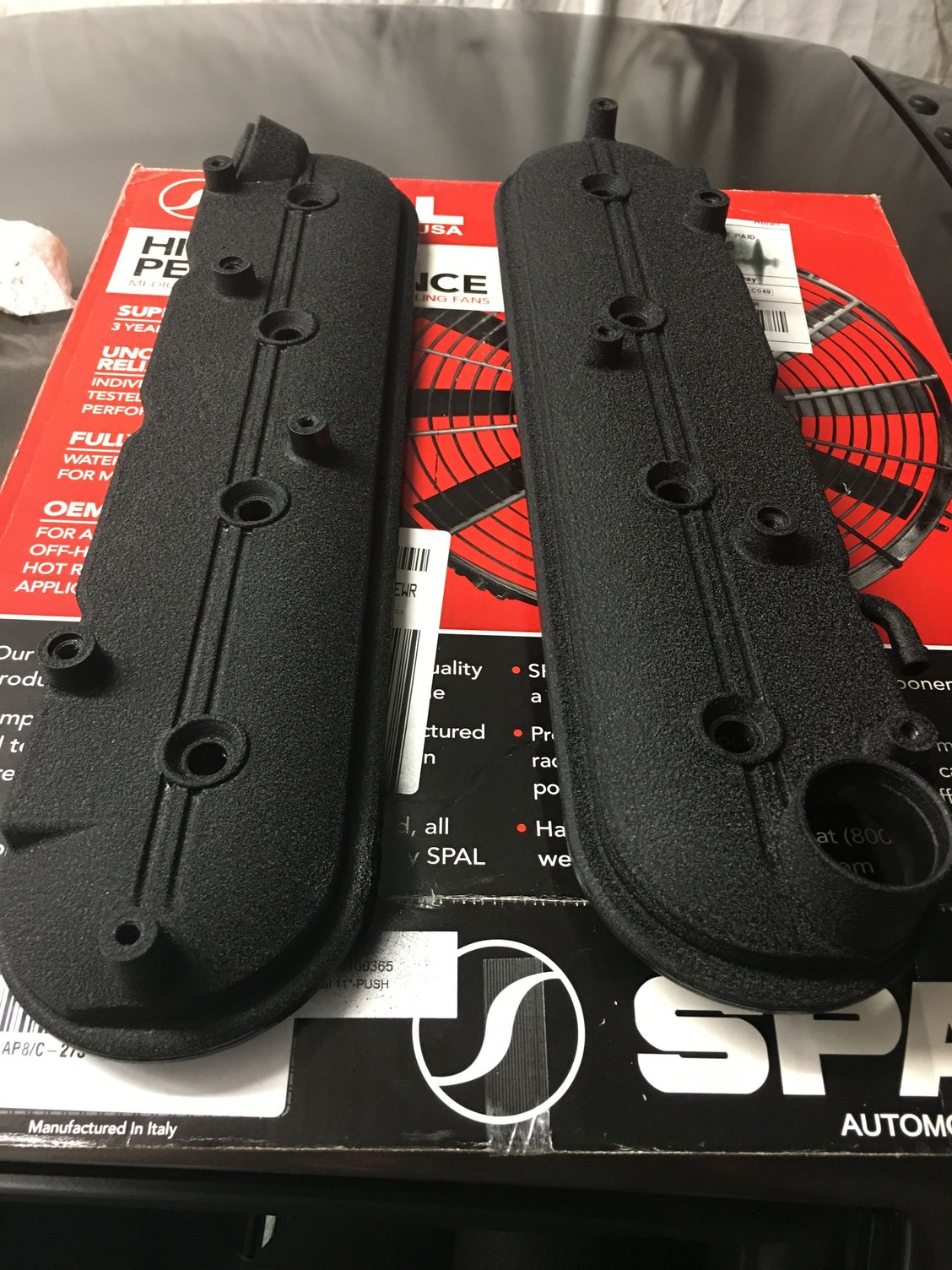

pozesd99''s Avatar
Joined: Dec 2007
Posts: 1,541
All my ***** painted!
.....DDAAAAAAAMMMMMMNNNNN...Real nice work on em!
Seeing that, I think I'll save some money and just paint as well.
No issues with the Duplicolor Engine Enamel with Ceramic?
Old Nov 8, 2016 | 07:48 PM
pozesd99''s Avatar
Joined: Dec 2007
Posts: 1,541
I used the wrinkle finish stuff and let it bake. The brackets were sprayed with a "chrome" spray
