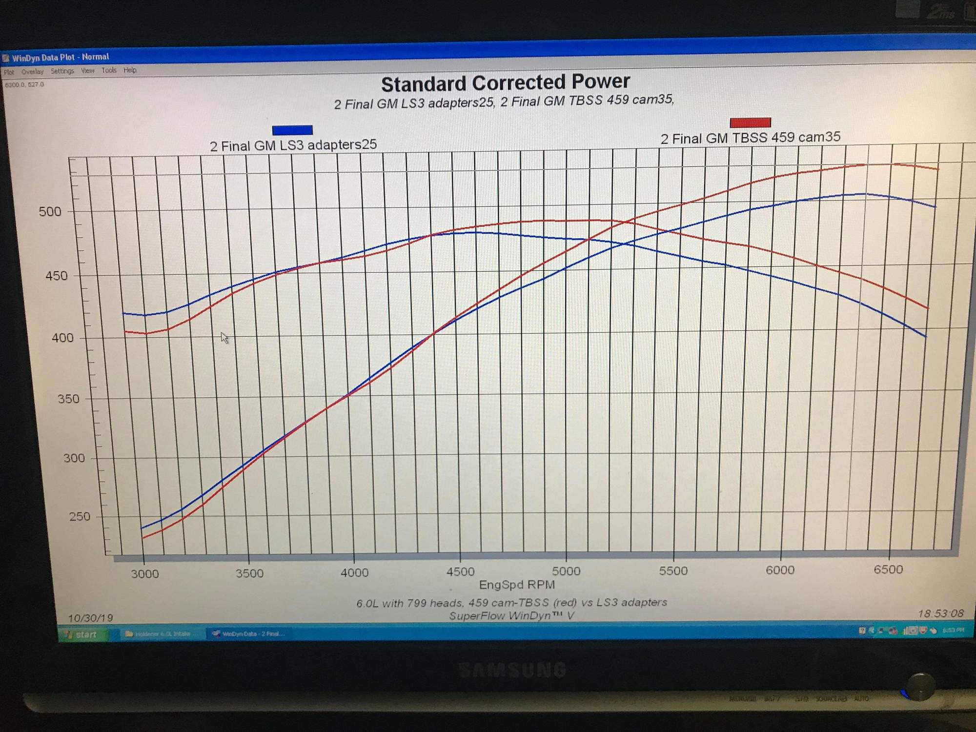

But has any testing been done on this? The LS3 looks great on paper. Wondering if its worth the swap from an LS6 to an LS3. I wouldn't mind the larger TB and they seem to perform much better. I haven't ever seen them swapped on a 5.3 though. Feel like I could sell my LS6 and 78mm TB and basically come out close to even with an LS3 and adapter combo.
When looking at this post it almost appears they "fit" around the port "as is".

Holdener sent this to me months ago.

Hey, that's very helpful, thanks! I wish I could squeeze the TBSS under my hood. But I can't justify cutting up a CF hood. Looking at the LS6 VS TBSS it doesn't look like that LS3 is doing much more.... May be stuck with the LS6 for now.
The dorman LS2 intake matches the TBSS throughout the entire rev range, but I'm not sure I could trust the Dorman with boost.
