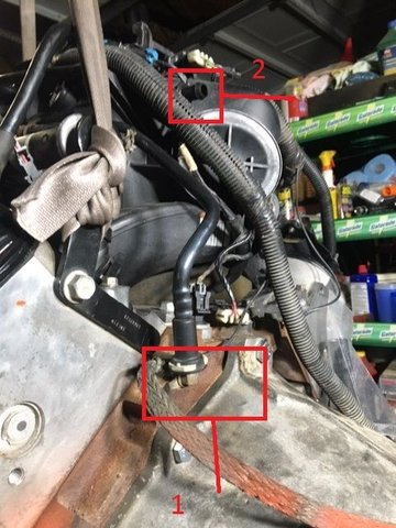

I need some help. I had a full pull out motor out of a 05 Denali and I had a few questions on a picture that I attached. I labeled two different items 1 & 2 in red for easier reference and I am not sure what they are supposed to go to. Vacuum lines maybe? Any help would be greatly appreciated! Also, does anyone have a picture of an LQ9 wiring harness to what each plug is used for? I have most of the wires/plugs hooked up already, but there are a few plugs left over that I dont know what they are for...

#1 - Evap line that goes to the solenoid at the front top side of the intake.
#2 - Vacuum port on the back on the intake that goes to the brake booster in the trucks/SUVs.

#1 goes to the gas tank to relive pressure built up inside the tank. On the Denali it would have gone back to a vapor canister solenoid, the solenoid would connect to the charcoal box, and the box connects to the gas tank

It looks like those head/s have been off before. The little heat thingy is on the back of the driver side head.

Okay cool thanks guys. I'll just remove them and cap it.
The motor was a full pullout. I pulled the heads off to swap to Ls9 head gaskets.

Trans has been removed before as well. Noticed the non factory bolt in the bellhousing peeking out from behind the ground strap under #1.

Yes I know. It had a 4l60e. The motor is out of an 05 Denali. I swapped it with a 4l80.
